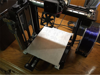

WooHoo! Plate has arrived! Beautiful bead job Jim! Gives the ol' gal a fresh new look!
(Gonna order up some of the ePC too.....stuff is like a rock!) Many thanks! :D
