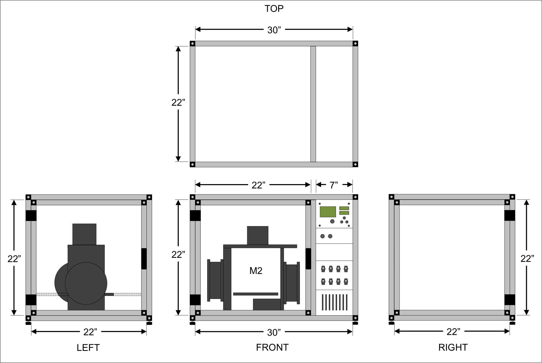

In my leisure over the last couple months I have been building an enclosure for my M2. Once I get closer to done I plan to post a load of pics and details. Before I started building, I used powerpoint to put together a layout which gave me a pretty good idea of how the enclosure would look, but mainly so I could visually account for how much 80-20 I would need.
