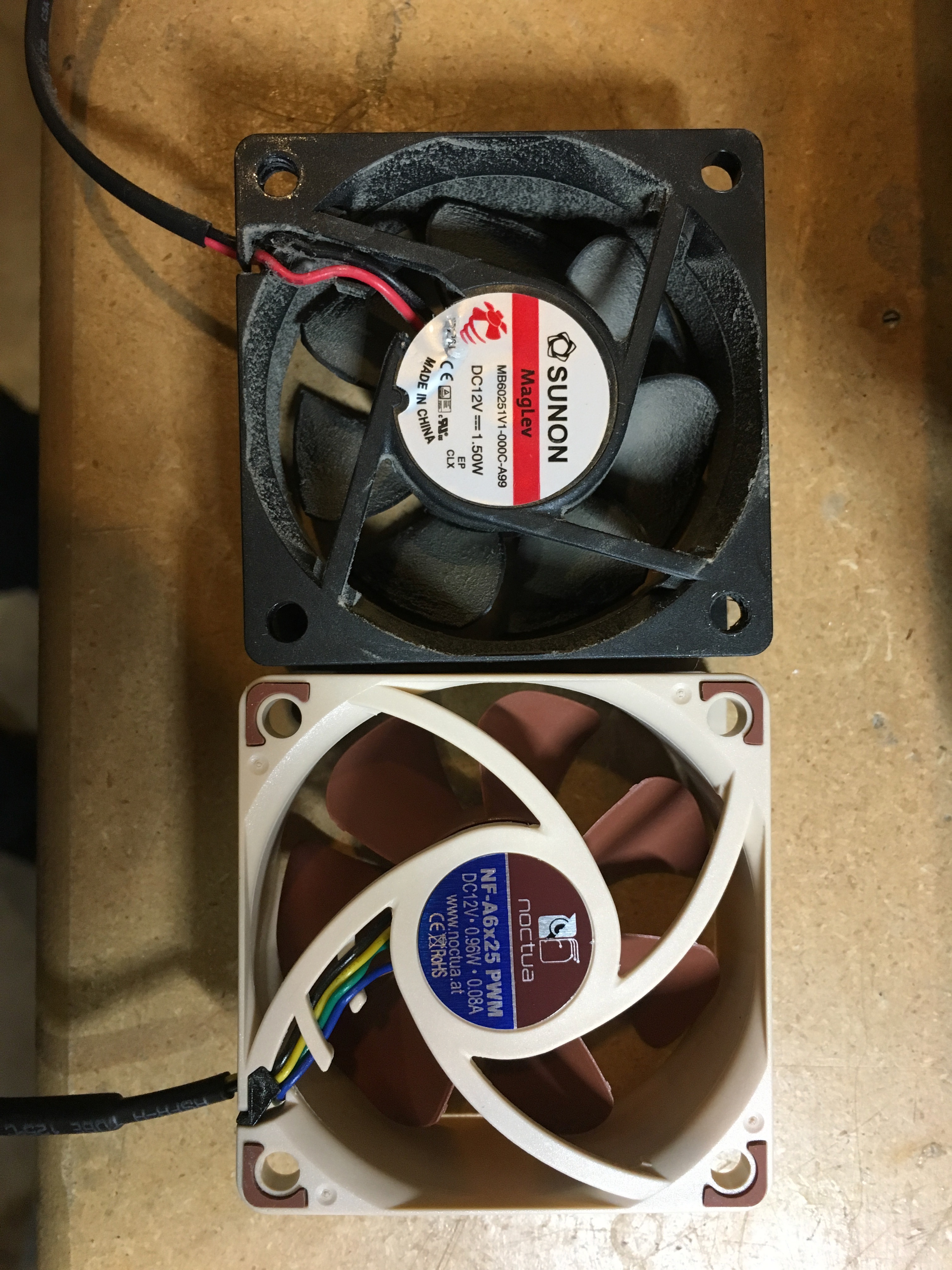

If I am replacing Power supply fan with a Noctua,
the power supply fan has red and black leads. the noctua has black, yellow, green and blue.
I assume the two blacks are common, which color on the nocuta corresponds to the red?
also which way should the fan face outward? With sticker outward or inward?

Re: Quieter Fans
Fan should exhaust - so judging by the photo it looks like sticker out.
Yellow lead is typically for tach, which does not apply.
Editing this because I didn't see the new fan has 4 leads. Don't know on that one.

Thanks I just resolved, I realized I purchased the wrong fan, but I had one of the correct ones with only two leads out. All is working. Thank you

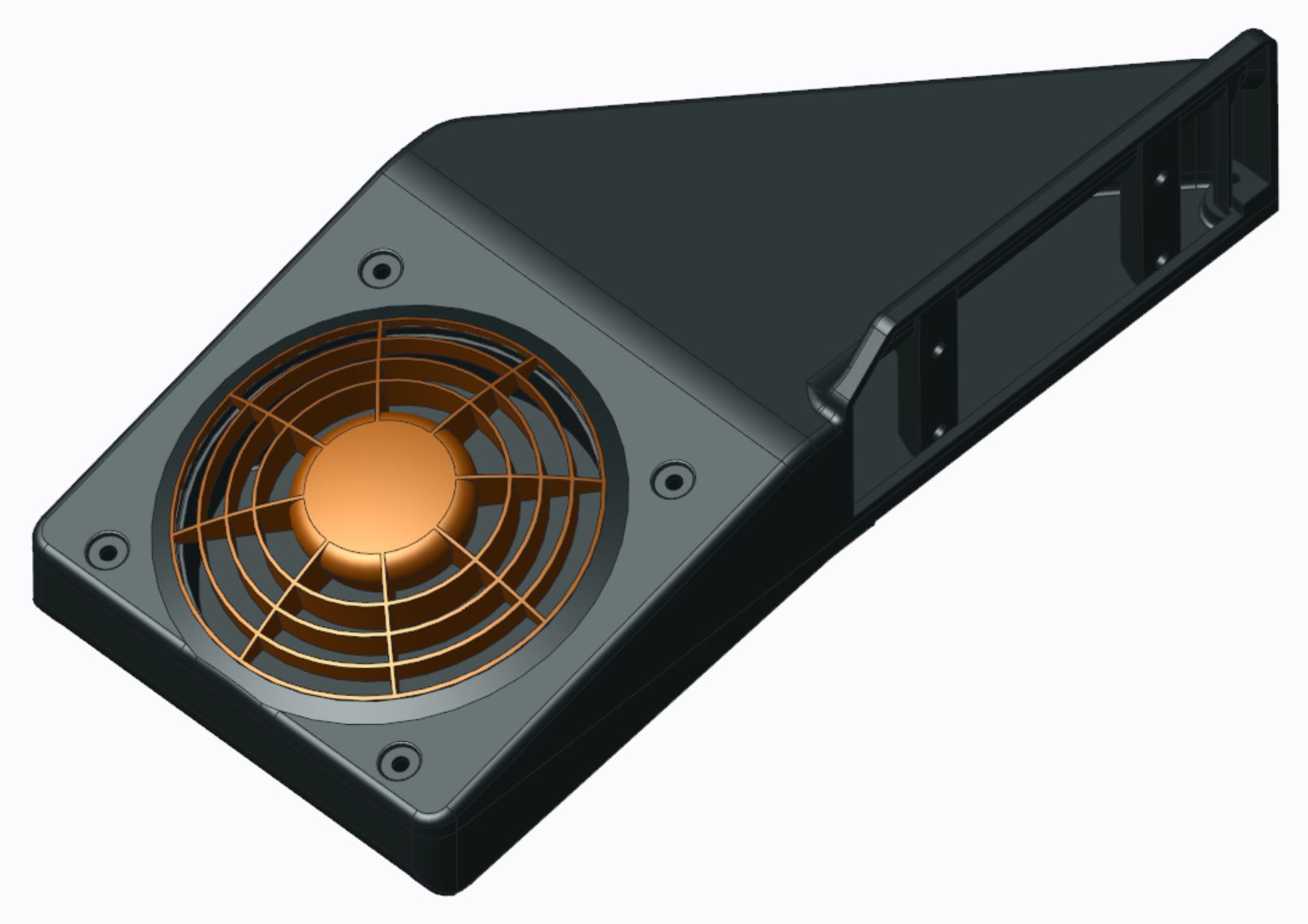

Zipped step file attached.
There are a couple square bosses that hang from the upper housing. Those are for a ceramic resistor I used to slow the fan. You can remove those if you have other plans electrically.
This attached to the grill features on the electronics box with over-sized washers to cover the gap. I might have printed stepped washers. I used #4-40 screws. There are slots to house hex nuts. #4-40 screws also screw the halves of the housing together. M3 would work in the same holes.

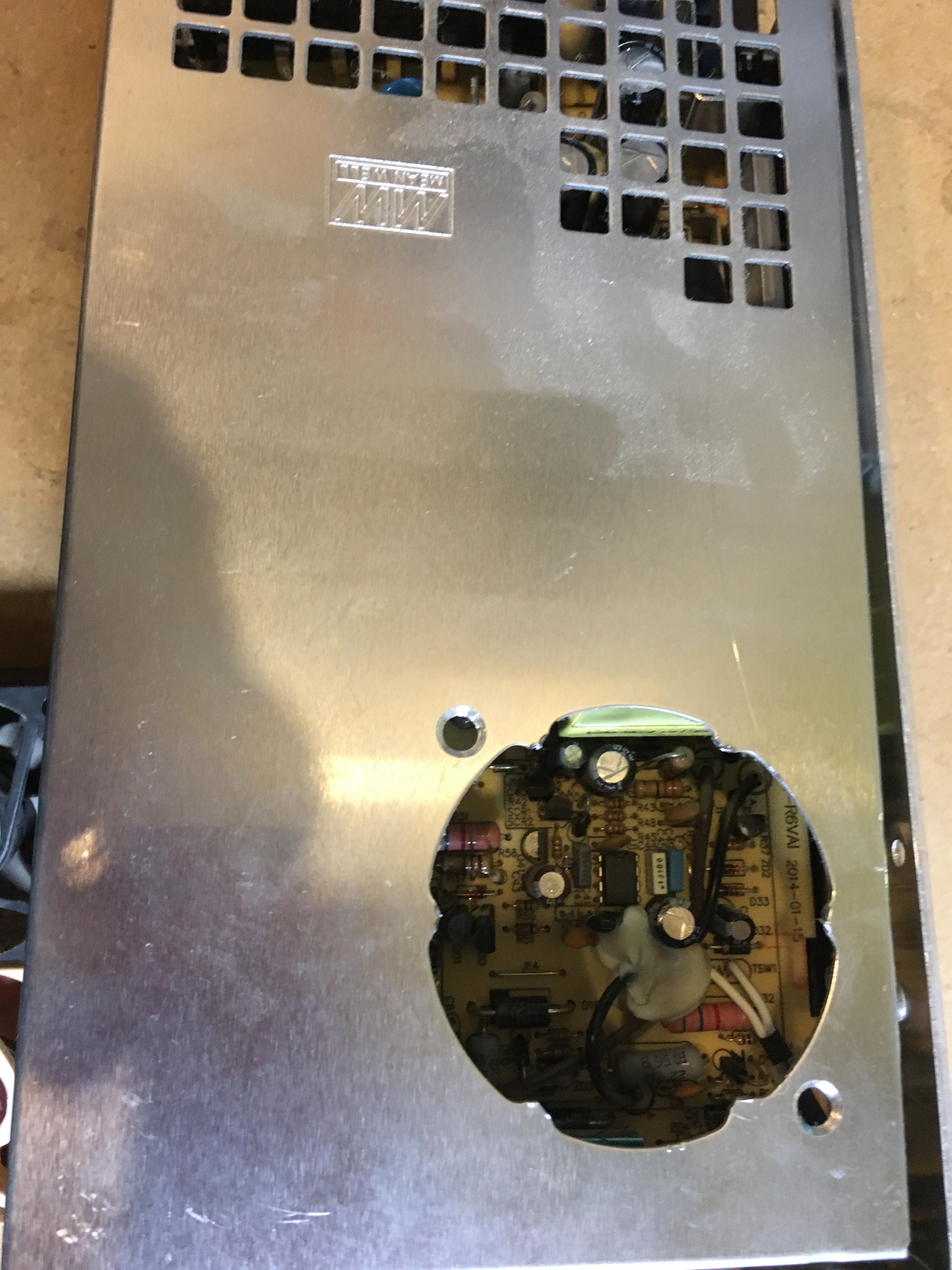

I also replaced the fan in the power supply but while doing that I cut out the metal grill of the inside case which increases air flow and reduces noise.. .. Used this have had it running in my original m2 for over 2 hears and now in a second m2.. Both running at the same time.. less noise the one original https://www.amazon.com/gp/product/B00VX ... UTF8&psc=1
