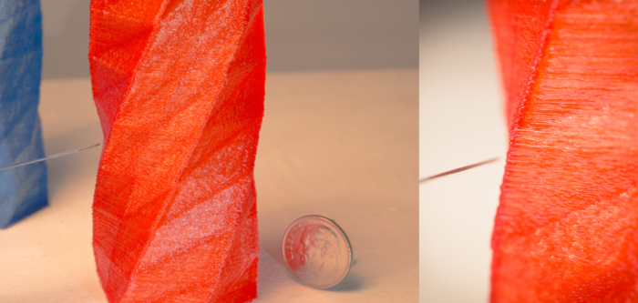

Thanks for the link. I looked at that guy and it is a neat idea but we are already much better using steppers. Look at the twisted vase, yuck.

There are a couple of problems with the path they chose. First, Backlash. This is the enemy of ALL mechanical systems. This is displayed as the slop between forward and reverse. It is hard to get rid of and plays a HUGE part in accuracy and precision for mechanical systems. The steppers that we are all using now are going to be much better that these in this regard. The stuff in am working on is going to be much better in every respect for just a little more money. As of now I do not know of any system that are as good for 1/5 the price. I am just trying to improve on an already capable platform to make the output that much better, quieter and more consistent.
