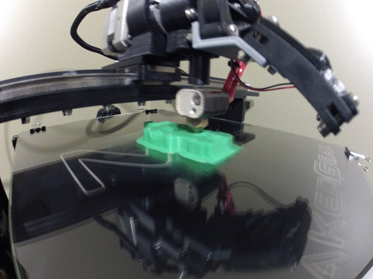

Aloha Guys, I think I have it figured out!
I had the tension bolt too tight. Once I backed it all the way out it stopped jamming.
Jim I think I grabbed this profile from another of your posts and tweaked it a bit.
Its printing right now and looking good.
Thanks for the help guys!

Made the changes and started the fan cover and the duct!
Im really happy with the drive. Ive probably printed it 6 times or so hehe.
Man, those pet+ supports are a bitch to remove!
Thanks again,

Well the extruder stopped extruding when printing the two parts so I started it again with just the fan shroud.
Reprinted the drive part due to the supports being bonded to the part.
Here is the new profile with the support changes. This seems like the good one. Two parts printed with no problems and the supports came right off.
I think I'm going to toss the grey abs and go with pet+ from now on.
Will post pics once I charge the batteries for my camera.
Mahalo, John
