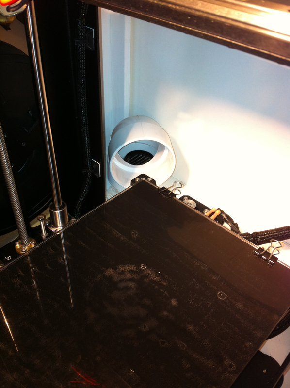

Here's some feedback on the heated enclosure so far. Basically you never need to run the hair dryer because the machine heats the cabinet up enough as it is. In fact, if you want to run with the door closed you actually need to use the cooling fan to keep it in a range that won't overheat the steppers. However, the hair dryer set to blow cold air is actually very useful for cooling off the build platform in a hurry. In the picture below, you can see a 3" PVC elbow redirecting the hair dryer air to point at the build platform. I'm going to just add a separate manual switch for the hair dryer and use it primarily for this purpose, since being able to pop the part off the glass without waiting around 15 minutes is nice.
As for ABS warping, I still get gear teeth curling up due to shrinkage when not using a raft even if the chamber is at 110 F and the build plate is at 100C. Using a raft fixes that problem though. The cabinet is really great for noise reduction though, especially if you have to work sitting right next to it all day.
