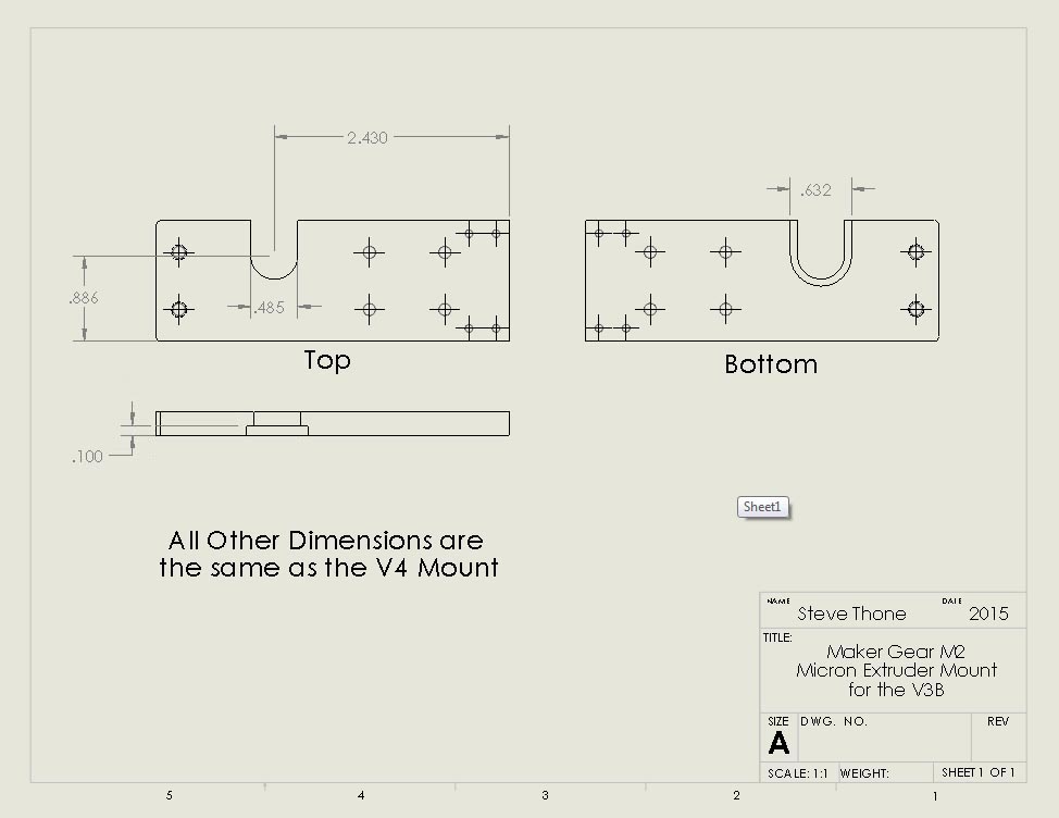

I don't know if anyone will ever use this info but here's the specs on the mount I made for the V4.

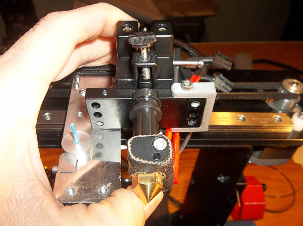

Seeing as I've gone this far..... and I was swapping out some screws on my extruder mount I test fit the V3B hot end and it fits almost like the extruder was made for it.

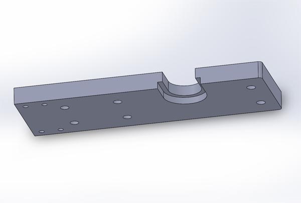

The mount for the V3B is probably a little harder to make as you would definitely need a mill to make the stepped section so the hot end would slide fit into the mount. The bad part is you can't just slide it out to remove the hot end without unbolting the entire extruder because of the way the bottom of the extruder is cut. (unless you mill that out too.)
But just encase someone is really brave and wants to try it here's some quick dimensions that might help. (looking back at the first picture, a step on the top part of the mount might be necessary also as it looks like the hot end doesn't quite sit flush in the extruder. I really didn't notice it when test fitting it.
Anyway if anyone else is crazy enough to try it hopefully some of this info will help.

Wow, honest to goodness drawings. What do you use?
Re: Micron All Metal Extruder Upgrade
Post by sthone » Wed Apr 01, 2015 3:26 am
Solidworks, I even pretend to know how to use it sometimes too. :D

Post by jimc » Wed Apr 01, 2015 3:40 am
funny, by looking at the picture of the mount above i could tell it was solldworks. it has a unique look to the models when displayed on screen. almost cartoon like.
