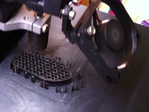

Post by Jules » Thu Sep 10, 2015 11:41 pm
Had some almost empty MG black PLA leftover on a spool, and decided to just print a little Benchy with it to use it up. (First time doing one.)
Anyway, i was impressed by how well the Zebra held on to some extremely tiny supports while it was printing, so i took a quick shot - (in the interest of complete disclosure though - right after taking the shot i leaned in too close and knocked a couple off with my hair, and the air printing dominoed the situation. :? )
The good news is - the fan guard removal makes the supports completely unnecessary - no warping at all.
And the Zebra still gets credit for holding on as long as it could! (Just try not to "become one with the print"!) :lol:
Terrible photo but the bed is in motion:
