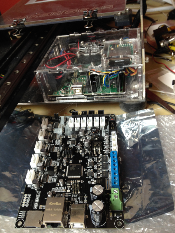

Got the board today ... looks pretty easy to connect. Waiting on the 24v ps and hbp .. with any luck it will arrive tomorrow.

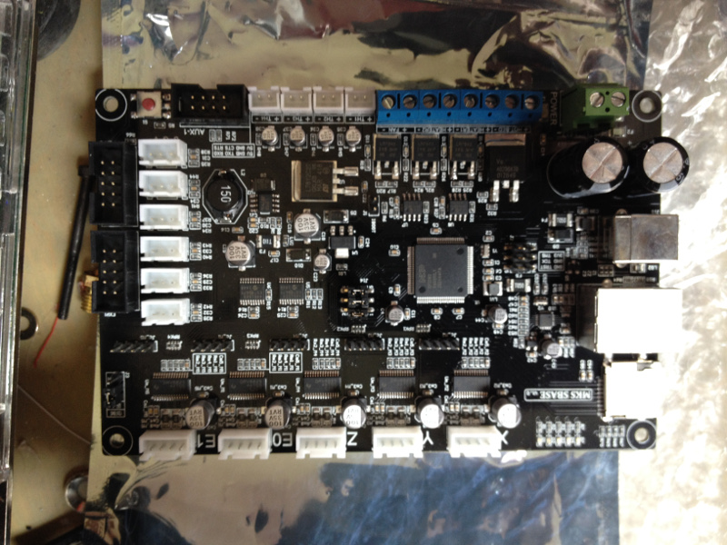

I hit my first snags with this board.
On the wire to board connectors pin depth is about 1/2 as high that of the Rambo. I'm not very comfortable with the amount of connection i am getting when using the existing plugs..
What I may to do is remove the ones off the Rambo board and put them on this board.
EDIT: pulling off the white plastic surrounding the pins makes them the right length... and is a pretty easy fix.
Second issue is noting major. there is only one fan connector. Since the case / stepper fans run all the time anyway, i'll wire them straight to 24v.
i could possibly use the unused second hotend mosfet, but seems like a waste. plus id like to leave open the possibility to add a second hotend.

Post by innkeeper » Fri Jul 03, 2015 7:46 am
Tim wrote:Yes, nice looking, but quite a different layout from the one I have. It looks much longer front to back, for one thing. It's definitely not going to fit the enclosure I designed.
it is definitely a different footprint. i've got it mounted inside the old case, but with the back removed with some insulation under the overhanging part.
I'll have to see about tackling a case design once i get it running.

Post by innkeeper » Sun Jul 05, 2015 6:41 am
Update: got everything hooked up did some test prints. everything works as expected.
took a little extra time to revert the m2 back to its original state. but electrically, its almost a direct drop in.
only variations from the rambo to the sbase were, needing to reverse the Y axis connector and
the fan needed to be connected to the e1 connector (that is likely a mis print on the board as the config file is defaulted to use that pin as fan)
(i'll post photos on the connections)

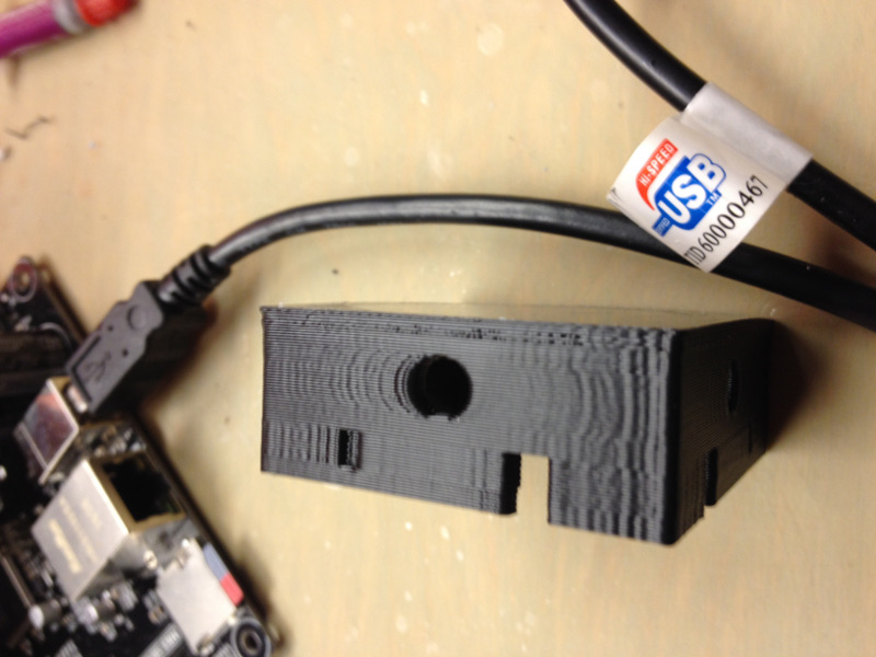

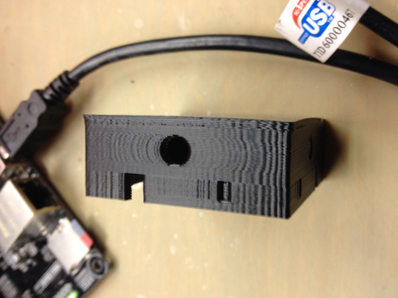

i did the same ring test print at .3 layer height with abs, just to see if i would similar results to tim, and i did using the latest firmware.
like tim, to even see the ringing i had to get a good reflection.
it looks bad but it really isn't. without a direct reflection, you cant see it.
x axis
y axis

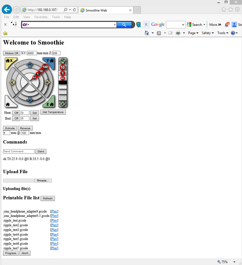

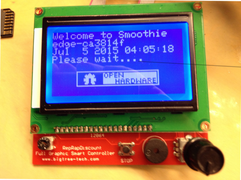

Post by innkeeper » Fri Jul 10, 2015 2:10 am

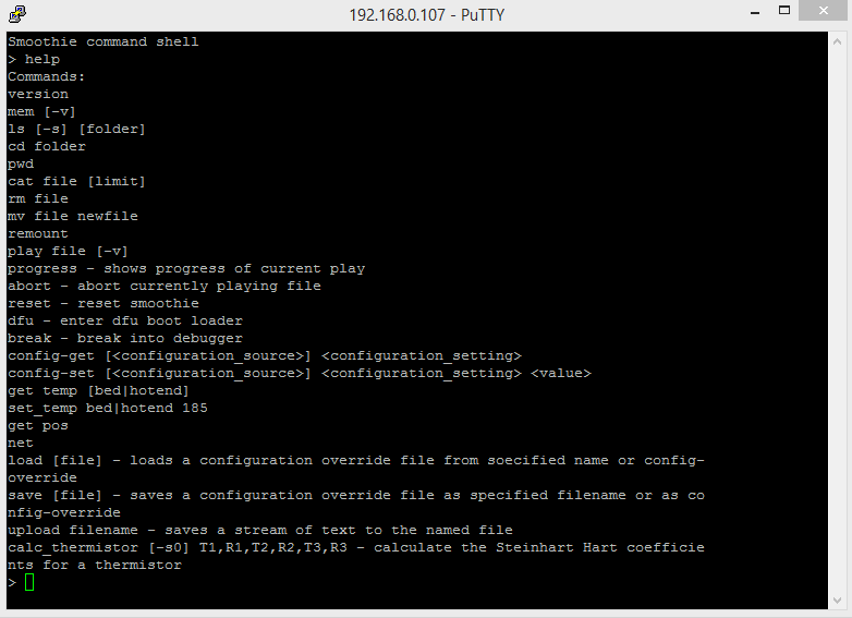

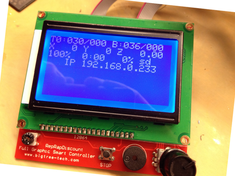

OK, so I got the 12864 graphic smart controller working - (connectors were reversed pin 10 is 1 so had to file off the tab to reverse them)
also got it on the network, and successfully accessed it via web and via telnet.
see pics:
I didn't take pictures of all the menus. the settings and controls are quite extensive.
I'm still playing with them all.
image (1)-800.jpg (183.17 KiB) Viewed 14260 times
Re: Smoothie M2
Post by Tim » Fri Jul 10, 2015 4:36 am
So that's what the web interface looks like. It's got a sort of embedded pronterface. . . interesting. I haven't got that working yet, but then I haven't tried too hard. I intend to look into what's really going on with stepper motor currents, but won't be able to get to it until sometime after next Tuesday. I am moving in August, which will put a damper on 3D printer activities. . .
