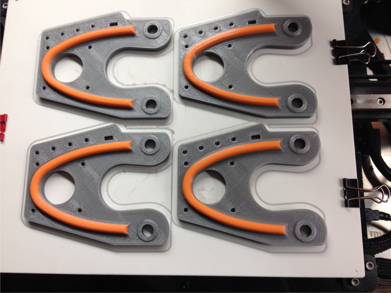

i've also used the suspend and turned the heaters off when i needed to pause the print because i was leaving the house for a while, and didn't want to run the print un attended, it faithfully picks the print back up ware it left off with no defects i could find. i included a Picture below that had both a pause in it and a filament swap (swap is obvious and done purely for aesthetics) this is is a high layer height motor mount print i am doing for the mostly printed cnc machine.the other upside to being suspended is you can jog things around without concern, it will pick up right were it left off.
