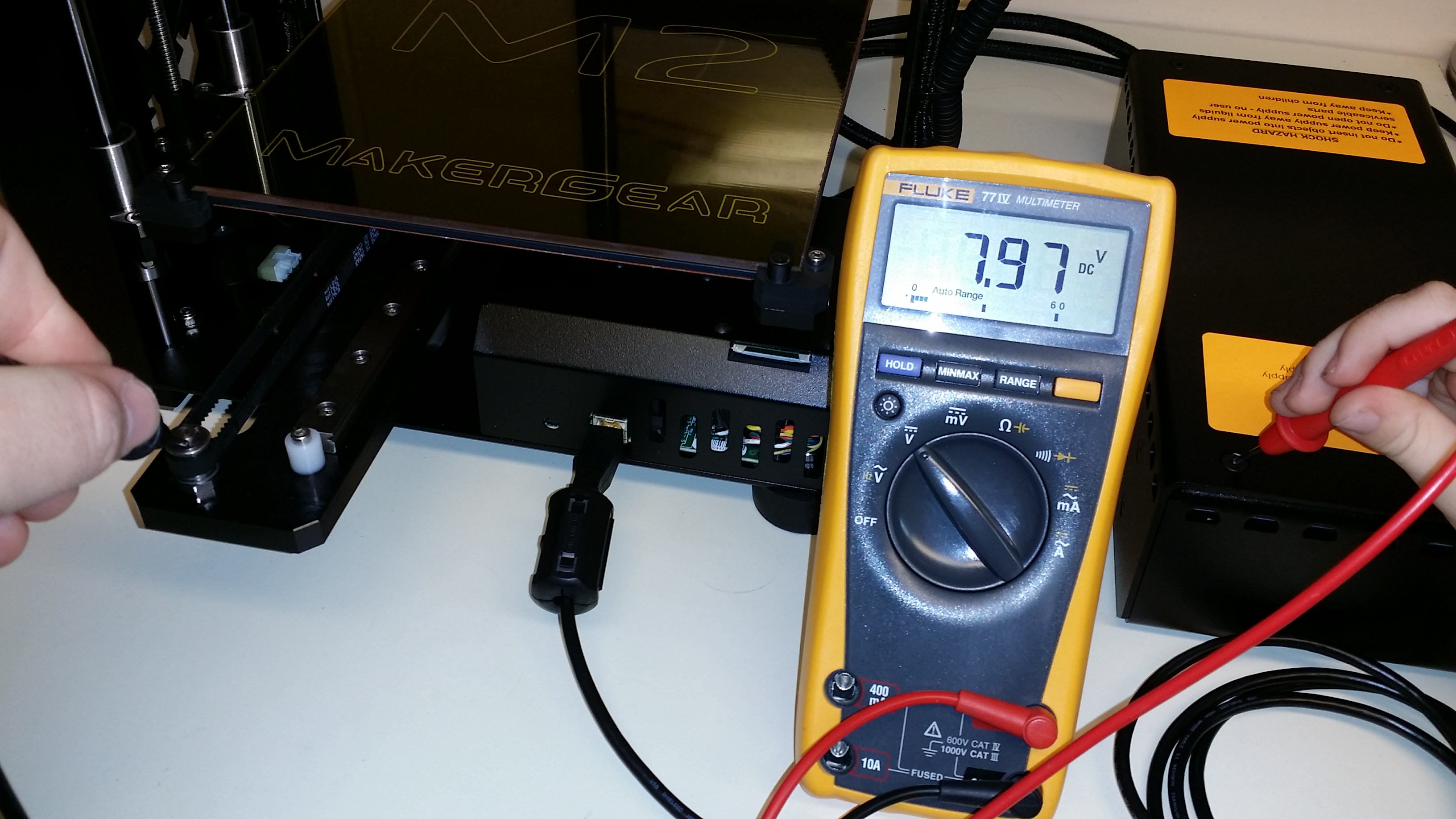

I was working on upgrading my 24v upgrade and I sat my arm on the end belt bearing and got shocked. So I broke out my multimeter. When the usb is plugged into my computer I'm getting a voltage between the pulley and the power supply. When I unplug the usb there is no voltage. Anyone have an idea?

Do you have a multimeter handy? I checked on the pulley and a screw on the top of the power supply. Its definitely a constant voltage.

Yeah, we found the meter - but no voltage on that span. Don't know what it is.....

Ok the plot thickens. When I print my laptop is plugged into the wall. If I unplug the laptop from the wall the voltage disappears.
