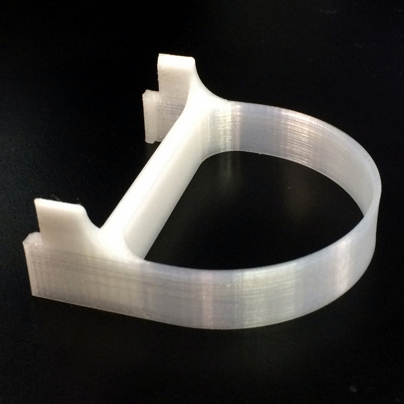

Finally, after three years, I got around to designing/printing a bed stop for parking the Z-axis. Snaps into place, no fasteners required. The hoop section functions as a spring and support. Can work successfully with PETG or Taulman 910. Photo and STL attached.

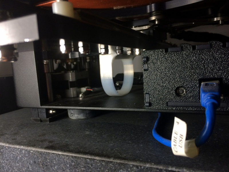

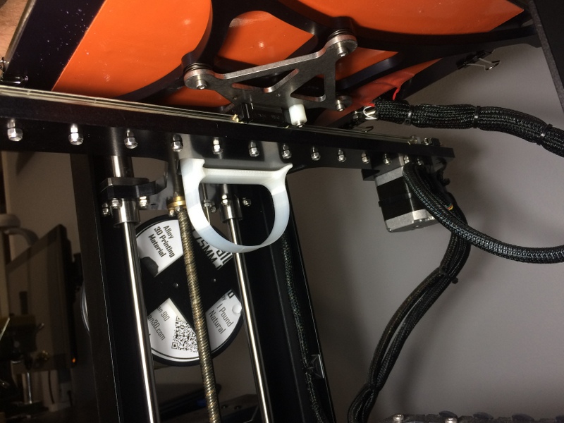

Post by quaver » Thu Sep 08, 2016 11:32 pm
Installed...
Bed stop installed, rest
Bed stop installed
