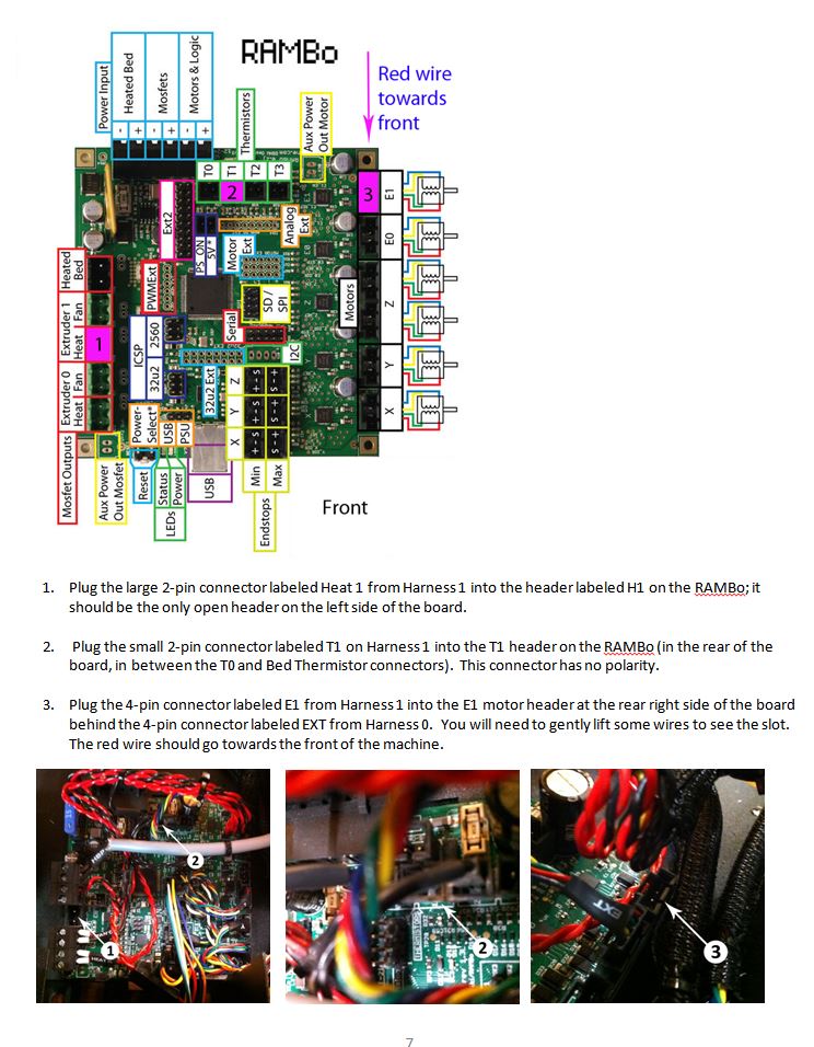

My extruder motor has stopped working. I've somehow fried the E0 output and its no longer sending a proper signal. I am SURE this is my issue (not cable, motor, etc.)
I use simplify3D. Could someone help me to utilize the E1 output on the Rambo board in place of the E0 output?

Sure you don't want to get a replacement Rambo? Or maybe check the fuses? (I'd trust MakerGear's instructions over mine.)
This is the correct placement for the plugs. You'll need to change your Tool to Tool 1 everywhere in S3d, and it defaults back to Tool 0, so you'd need to keep on top of it.
That's the limit of what i know - and no guarantees it will work.

Could you state what I'd need to change in S3D? I've tried that and haven't been able to get it to work.
Re: Rambo E0 output fried. Need help to utilize E1 output.
Hang on........
Okay, don't know whether this will work or not but it's worth a shot:
On Layer tab - change Extruder Toolhead Index to Tool 1.
In the Jog Controls - change Active Toolhead to Tool 1.
This of course assumes that you have changed the 3 plugs to the receptacles shown above.
If it doesn't work and you have a V3b nozzle, you would have to update to V4 before you could use the dual firmware, at which point it should work.
