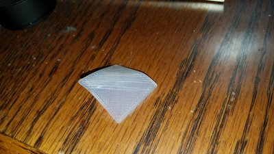

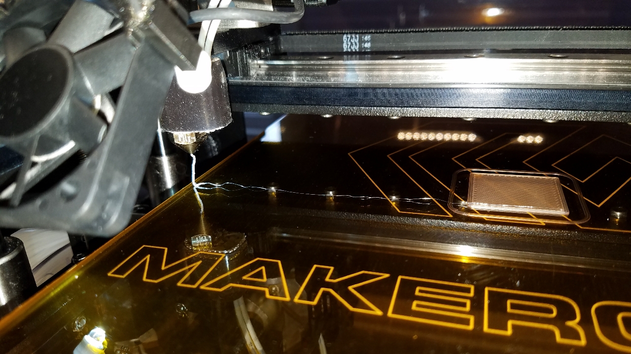

The square is .6mm thick and when I examine the bottom there are no gaps between the strands. However, if I bend the square the strands make cracking noises and do not seem to be fully fused.. (see photo) is this OK "Normal"? I nave tried 240, 245, 250,255, and 260. If I print at 260C there is no cracking but I am at the top of the heat range according to esun and not sure that is good either and I have a really hard time getting it off the bed, to the point or pulling the polyimide sheet.. At 245C with 4 outer walls, the outer walls actually completely separated from the infill center. The other question I have is about the leakage of plastic after printing.. is this just due to the .5mm nozzle size.. see photo Should I start the next print and not remove this it gets dragged into the print.

Both of those are moisture. You need to bake the filament in a dehydrator for several hours before you use it, and load-and-start it while the filament is still warm. PA sucks compared to normal filaments you're used to.

That's what I figured! Most if not all my extrude issues was the tension being too tight and distorting the filament.insta wrote:Both of those are moisture. You need to bake the filament in a dehydrator for several hours before you use it, and load-and-start it while the filament is still warm. PA sucks compared to normal filaments you're used to.
But man those parts are strong even with it wet! Will have to plan better I guess when I need something in nylon.. or is it better to just go with PETG for every day tough items that don't need to be nylon per say?
