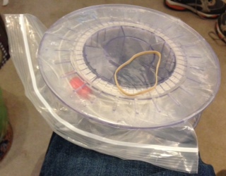

I struggled with how to handle / store my filament. Tried a number of different processes including using a small vacuum pump to evacuate the large ziplock type bags i purchased on-line. The vacuum pump was a hassle and it didn't take long for the seal to allow more air back in the bag.
2 plus years of experimentation resulted in the following recipe - its quick and easy.
Large zip lock bags 12 X 15 - 4 mil (I tried 6 mil and it was too stiff to work with - no good seal) found on ebay - https://www.ebay.com/itm/ZIPLOCK-BAGS-1 ... SwnDZT6YjH
Bag of #33 rubber bands https://www.amazon.com/gp/product/B003S ... UTF8&psc=1
Desiccant I like the color changing - you can tell when it's time to recharge the pak https://www.amazon.com/gp/product/B01LZ ... UTF8&psc=1
Easy Peasy - drop a few Desiccants in the bag, drop in your spool of filament - zip it almost closed leaving a small opening - kind of center the spool in the bag - grab a rubber band place it around the bag and work out the air - place another rubber band around it on the other side of the opening you didn't close yet (you'll see what i mean once you try it) - close your zipper opening and place it in storage. - your done!
With filament that has been out a long time i bought a dehydrator and opened up a couple of the trays big enough for a spool, and i dry it out that way. - always works pretty well..
Happy Trails - Lowell
