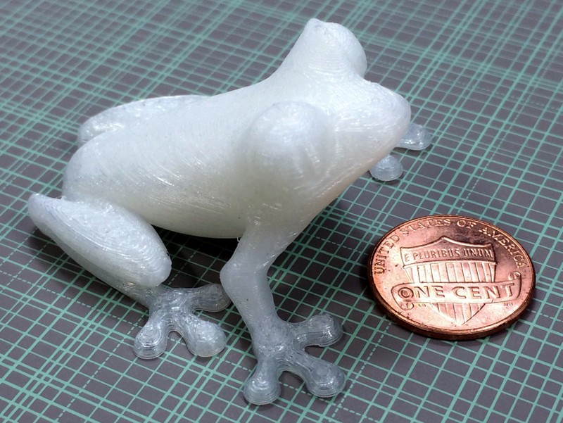

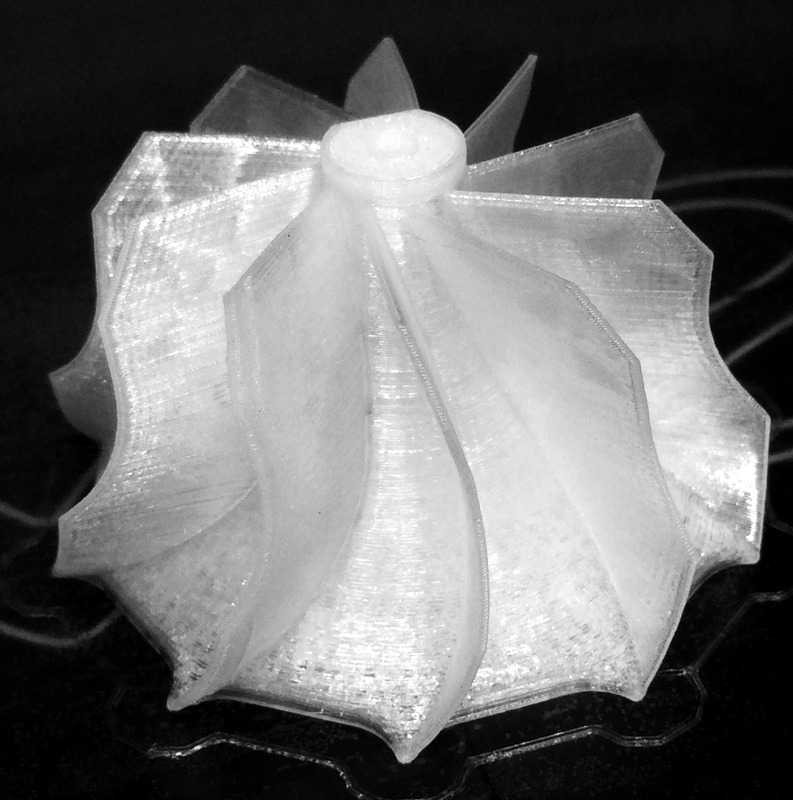

I have started printing with Taulman Alloy 910 and am pleased with the results. Good bed adhesion with glue stick on PEI, 45°C temp. Extruding at 260°C with a 0.35mm nozzle, V3. Printing at 50mm/sec. Inter-layer adhesion is exceptional and I have not encountered any warping. I am printing at 0.2mm layer height. Strings are minimal with no blobs at start/stop points. Have yet to evaluate bridging characteristics. Drills/mills nicely for post-print work. Can be easily dyed with Rit and accepts the color fairly uniformily. Not sure why I would use PETG over this for most print jobs. Here is my FFF and two sample photos.

Very nice job. What is the thickness of the pei you have.
