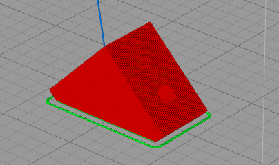

CCVirginia wrote:I should have been more clear. The corners (and some short sides) are pulling up, not hanging down.
Can you provide a photo? Some objects shapes make printing with PETG a real pain, for example rounded corners facing down tend to bend up. Another thing that curls the material upwards is printing a slope with many outer shells, the more often the nozzle touches the previous part the more these curls occur. Better go with two outer shells and 100% infill instead of six or more outer shells. Add a raft with one layer only and add support "from build platform only". It might help a lot.
Take a look at the pictures. This is piece to connect mitsumi 20mm extrusions in a 90 degree shape. When printing like we would normally do with a flat side to the bottom there is much force involved trying to pull one side up as the printer builds this thing up. Most of the time this ends to a deformed piece with abs or petg.
The stress is reduced by flipping it by 135 degrees forming an equal-sided triangle. This piece stays in shape and prints very well.

My eSun opaque black PETG would have no problem with the first picture.
