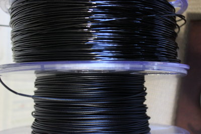

I just ordered a new roll of eSUN Black PETG for the first time in 5 months and it's different than it was before.
The filament on the roll is completely shiny and smooth....it used to have a texture and the surface was flat in color.
If I flex the material by hand it seems to have the properties of PETG, it does not turn white where it's bent like ABS, so I don't think that it's mislabeled.
I ran a few calibration prints, then started an over night print. In the morning, I found that it had only completed about 25%. Something jammed. Iv'e been through more than 20 rolls of PETG and only had one jam....this is troubling.
Has anyone else seen this?

over time i have had their stuff vary from textured to smooth. its just an external they put on the filament. nothing more. the texture does allow smoother sliding through feed tubes but with hard plastics it really shouldnt matter much . thats more important for flexibles like ninjaflex

The earlier stuff from 2015 is textured.

In the past (and still in transition), the surface might be smooth or textured. Both print fine no difference. However there were always questions from customers about why we have textured surface, especially new users. Based on feedbacks, most users prefer smooth surface (probably because it is prettier:)). We have as such started to produce smooth surface only. You might want to tight your drive gear a bit more. The smooth surface certainly has less traction than textured surface. A good reasonable teeth mark should be enough.
PETG has not had formula changes ever since its debut 16 months ago.
