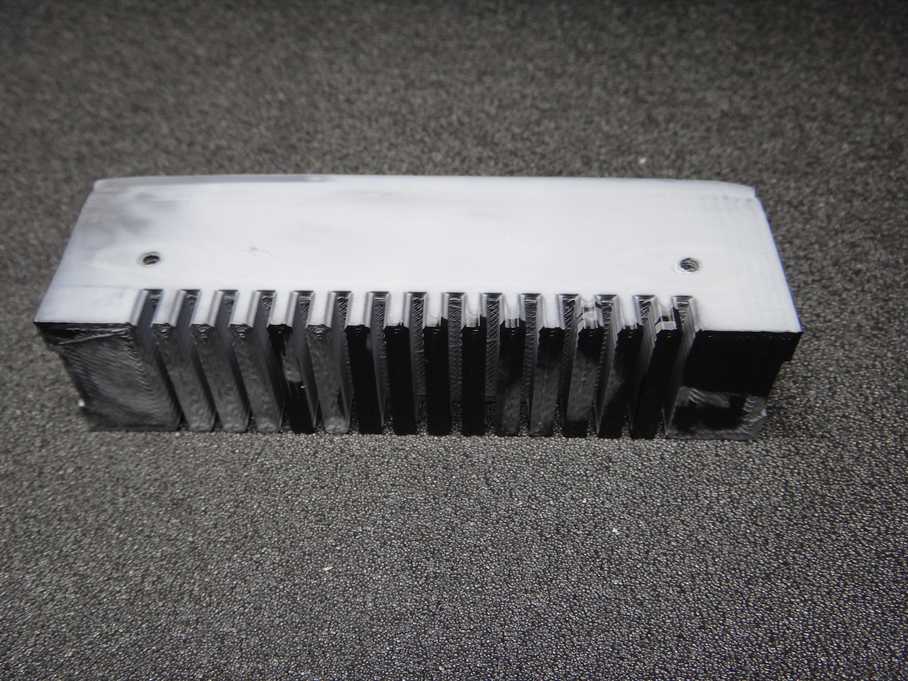

Thanks everyone for your input. I will have to get some of the Bridge, I think that will be best for now, I did some experiments with the solution that contains some acetone this weekend when I had some time in the lab with a PLA printed part. In almost no time it took the color out of it. I just dripped some onto the part, and waited probably 10-20 sec max before rinsing it off. I can't remember our mixture, either 50% acetone/50% ethanol or it could be 80% isopropanol/20% acetone.
I use MakerGear filament.
DSC02845 copy.jpg (517.49 KiB) Viewed 26936 times

Post by jsc » Wed Nov 19, 2014 5:56 am
I printed a platform for use in my acetone vapor smoothing setup in PLA. After exposure, it became flexible and warped. Not sure if that was the acetone exposure or the heat that was the main culprit, though I have read elsewhere that acetone does indeed make PLA flexy.
