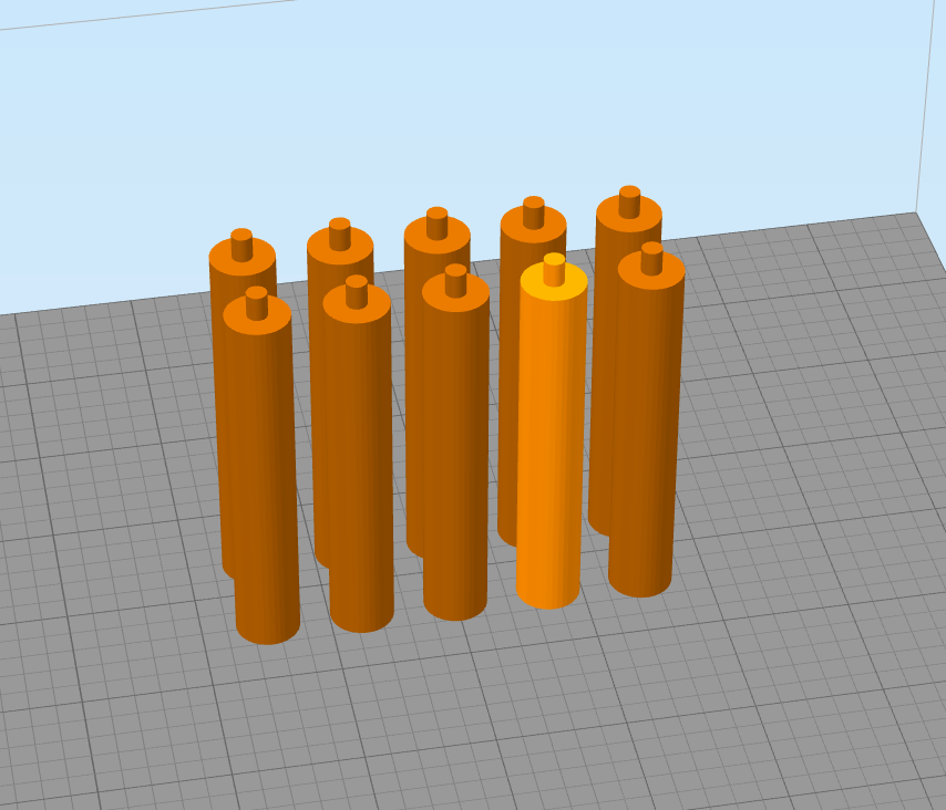

So I tried out what I would call a semi-advanced ninjaflex print, and am getting mediocre results. Lots of string, and holes in parts of the models. They're basically 10 parts of a long tube. See the attached S3D render (it's currently still printing).
What am I doing wrong? Here's the pertinent S3D settings:

Once it gets done printing I'll post a picture. I can probably salvage it since the tubing is actually supposed to look a little beat up... but I haven't tried printing anything this hard either in Ninjaflex before. Frankly I'm concerned about doing another larger piece just because the blasted stuff is so expensive that I don't what it messing up on anything that needs more accuracy.
It could also just be in the print. The first 20-30 layers actually look pretty nice.

For starters I would print those one at a time so you don't get string from the travel between parts.
Re: Ninjaflex print very stringy & holes in the models. Why?
Post by jimc » Sun Mar 01, 2015 5:46 am
in addition to what steve said, if your using s3d then spread those thing apart a bit, set up sequential printing so it only makes a half dozen or so hops between parts. in the end you only have a few blobs per part to razor knife off instead of a few hundred. i find that ninjaflex prints nice and clean but its the jumps that kill it and make the print look like poo. if you can keep the jumps from part to part or area to area to a minimum then your ok.

Thanks all for the feedback. After doing some additional research and double-checking settings, the default ABS S3D profile only has infill set to 20%, which it seems is far too little. Reprinting at 85% infill has improved things significantly in addition to spacing things out and setting up sequential printing. It's still stringy, but far less than it was before, and the model is staying solid better. I am wondering if 250C extruder temp inside my IKEA enclosure is too high?
I really need to do a test cube with this stuff and dial in my extrusion multiplier correctly, but I am under the gun of a looming deadline so I just went with what was posted in the other thread and it seems to be working fairly well.

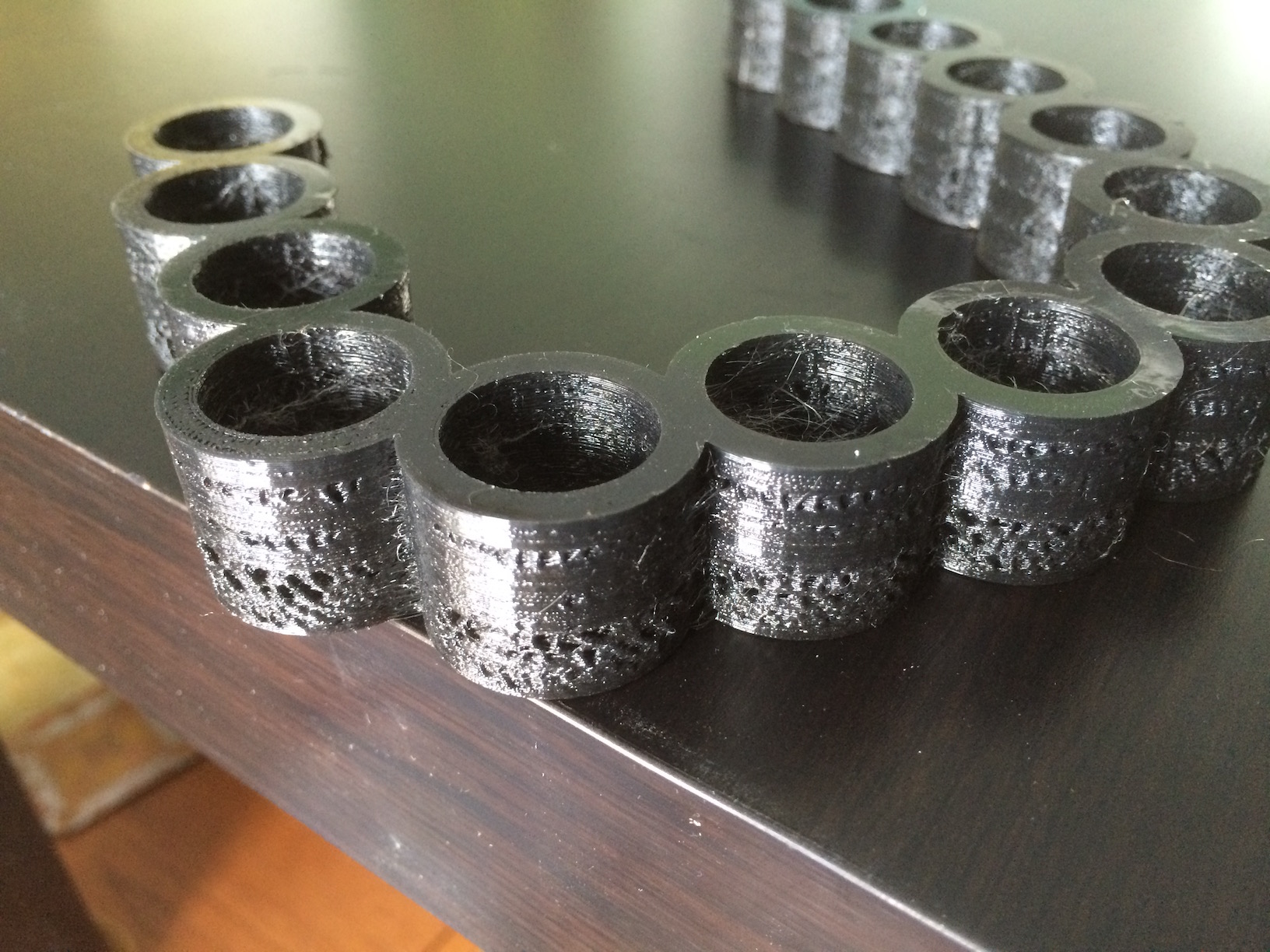

Spoke too soon. While much improve, still having what appears to be delamination between layers issues. Thinking this is a "temperature is too high" problem. Thoughts?
(506.18 KiB) Downloaded 526 times
Post by jimc » Mon Mar 02, 2015 4:36 pm
