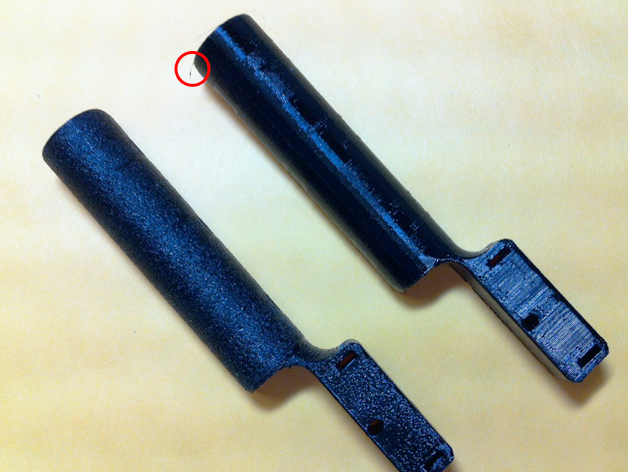

4. Under-extrude a little bit. It gives a much nicer surface. Whatever the Extrusion Multiplier is that you determined during the calibration, reduce it by -0.01. (So if your calibrated extrusion multiplier is 0.85, take it down to 0.84) PETG cannot handle over-extrusion without making a mess.
Normal extrusion on left, Slightly under-extruded on the right. Both prints are fully functional, but the left version is literally covered with thousands of tiny threads that wrapped around the print making the surface rough and glittery. The one string on the under-extruded print is the one that was left at the very end, when the bed moved down.

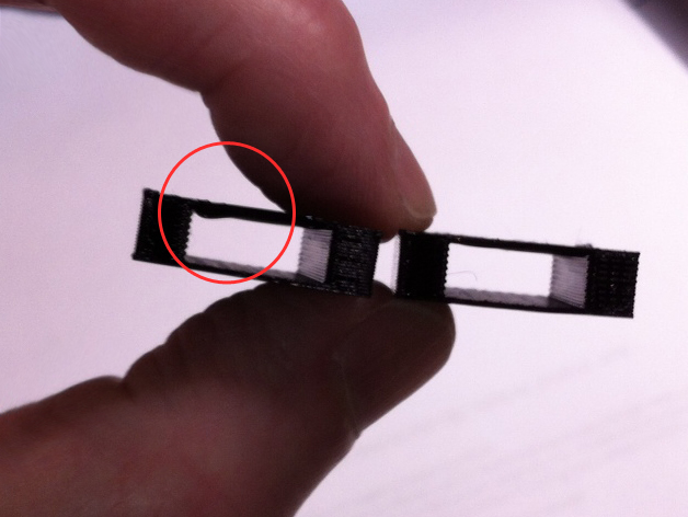

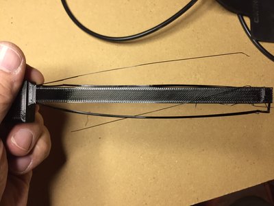

11. Bridging: The opaque PETG is damned hard to bridge. It sags, and the strands do not catch properly at the edges, causing build-up on the nozzle. They also draw out at higher bridging speeds, thinning, and providing little support for subsequent layers.
Bridging with no adjustments, full fan.
I’ve run several thousand bridging tests over the last few days, (slight exaggeration), and the best I can come up with is to increase the extrusion while bridging (to keep the thread from being pulled so thin that it breaks while it bridges) and moderately increasing the bridging speed so that it gets across the gap before it breaks. If you are running S3D version 3.01, you can also inflate the bridging distance by 1.0 mm, to make sure the edges catch. (Do not go over 1.0 mm though…too much, and it stretches and breaks again.)
The direction of bridging makes a big difference in the quality, with bridging along the x axis (from left to right) being best, and bridging along the y axis (front to back) being worst. Angled bridging falls in between.
Increasing the bridging extrusion rate and the speed helps cut down significantly on the sagging, as does extending the bridge by no more than a millimeter over the edge.

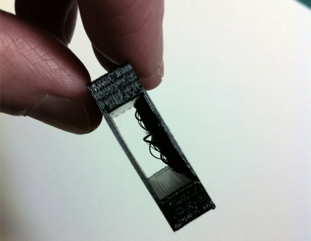

And one final note, and this one is a doozy – if you take the standard fan guard off of the bed fan before you print, the bridge gets a lot more cooling flow at the critical moment, and it cuts way down on the sagging factor. You do have to be extra careful not to drop anything into your fan if you take the guard off (those modifications, you know) but it’s up to you. The difference is very visible.
With fan guard installed on left, fan guard removed on the right. Significantly less sagging during bridging.
Bottom line: If you do have to use PETG to bridge, make sure you have multiple layers on top, and plan to ream out the saggy interior if you run it without fan.
