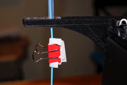

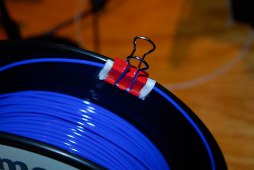

Simple tip of the day...... If you want to stop the tangles from happening at all, buy a bag of these small Binder Clips. ($4 at Staples)
Cut a piece of cloth or paper towel in a 2" square (meduim gun cleaning patches work perfect if you have them :D) Fold the square over once, then once more, and then wrap it around your filament and clip on the binder as shown. (now you have a filament wiper too.)
When you're done printing with that spool, retract the filament and clip the binder right to the spool (without removing it from the filament) and you never have to worry about it getting the crossed over again.
Simple as that..... ;)

Post by insta » Sat Sep 19, 2015 6:33 pm
Thank you for finally taking pictures of how I run my printers.
Guncloths are an amazing idea -- of to Amazon to check for them!
