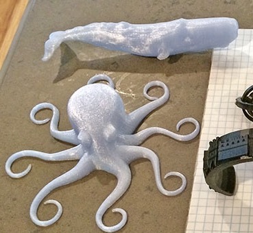

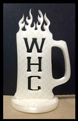

It is not transparent, only some pure high temp polycarbonate filaments get close to clear, even then, only in thin layers.
MG filament prints as a translucent white. Some "clear" filaments have a cooler tone, some have a warmer tone.
It is more obvious when you look at the actual roll of the "transparent" filament that you can't see through it. It reminds me a bit of the milky-clear plastic gallon milk jugs.
warm clear
cool clear

I was hoping that the natural PLA color would be somewhat transparent but just looking at your pictures I can see that this is not the case at all.
Thank you.
