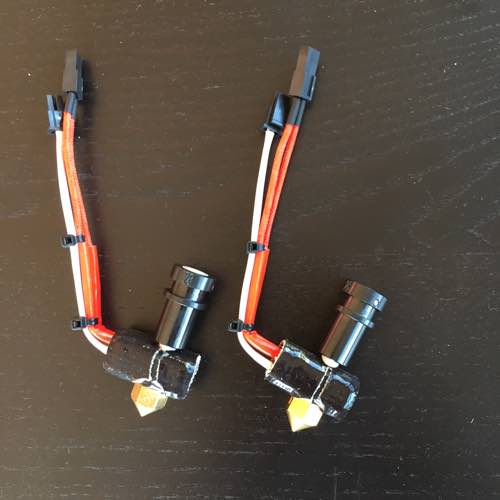

This is what I got.. are they both v3bs?

Re: v4 vs v3b extruder
If the mistake was MakerGear's, I'm sure they'll send you the correct one. But I would not get one of each. As Jules said, once you go v4, you'll never go back.
