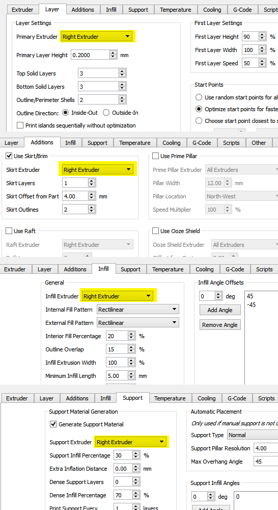

When you print from the left nozzle using the default profile, you need to make sure that you have set a Temperature for each nozzle on the Temperature tab in the default profile - I just noticed that it lists 0° temp for Tool 0 on the default. (That is an error in the S3D default, that i just caught because i don't ever use the default.
When you print from the right extruder, you will need to change the Tool that you are using from Tool 0 (left Extruder) to Tool 1(right Extruder) on each of these pages in the Advanced S3D profile settings:
