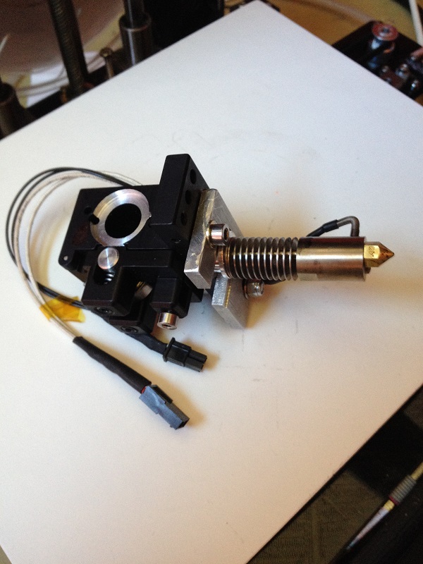

oh wow...nice write-up... I really should repost my approach to mounting it. it was totally different (edited and posted a pic) ... admittedly my approach required machining which most people cant do, but made it a lot easier to mount.
Edit....pic added... aside from the obvious milling I drilled and tapped an m4 hole to for a shortened standard mount plate. this allowed me to use the original plate mount holes on that side to mount to the m2's rail, shimming the hole with a plastic printed sleave (not shown), and using m3 screws to mount.... so it mounts directly, no adapter. fans mount to the existing m3 screw holes on the side using standoffs. I tried to take a pic at an angle that showed all the modifications
