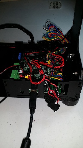

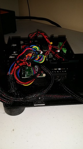

I've changed the E1_MS2 pin definition as you suggested and the thermistors read properly at the default 16x microstepping. But now neither extruder will work - I'd expect that for the second extruder but not the first. There was also some other weird behavior such as occasional erratic control of X, Y and Z, and the machine turned off twice during about a half hour of testing.
Josh wrote:... and anyway, the new harness that you both have is identical to each other, and to what we use now.
Actually, I'm still using the original harness from Jan-Feb 2013. I did not upgrade the harness, but switched to all 24V fans. See pictures below - there's a lot of extra wire in the harness.

Josh - Any more thoughts about the harness? brettb and I are both using that old style harness.
Because of the second extruder the signals travelling back and forth through the harness have changed quite a bit. The fact that the thermistor readings are strangely affected might be explained by interference, possibly from the longer unshielded cables of the original harness combined with the EMF from the additional extruder stepper and heater. I have previously seen weird behavior of the steppers on my CNC router due to shielding issues so I know it can be an issue.
