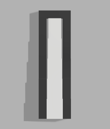

So, I managed to get the kit, firmware etc to work. Now I want to align the tools properly. Test prints are pretty good, but there is a slight bump along a wall that switches from one extruder to the other.
Any suggestions on how to go about doing this? I am thinking of designing a part that will allow to figure out what is the right x/y offset from the current setting, but wonder if this has been done already.

jsc wrote:Files and process are discussed in the wiki: http://makergear.wikidot.com/dual#toc12
Thanks. I am doing that, but this mean doing trial and error and at each doing a rather large print. I was wondering if more efficient process can work. For example printing an object like the one below where the space between the two pieces increases in jumps of .1mm
Re: Tool alignment - how?
Post by jsc » Tue Sep 08, 2015 7:48 pm
That's a good idea, but I would set up a print where you try to align end to end instead of edge to edge. The slicer settings can effect that, there are some "overlap" settings that control the amount of merging between coincident edges. If you align end to end, it should avoid that. I'm envisioning a single layer of lines that are slightly offset more and more, like a Vernier scale.

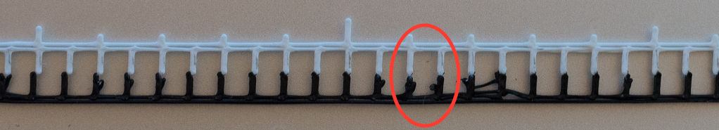

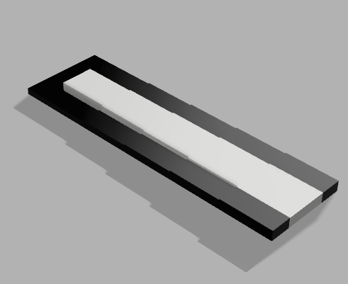

I managed to create this file which Simplify3D is willing to slice - each shift is 0.05mm which I think is fine enough. Each line is one extrude operation, so it is as thin as it can get. I'll try it tomorrow and if it works will upload to thingniverse....
update: this is on thingverse - http://www.thingiverse.com/thing:1006549
When printing I get (not the very best quality print :-( ) but the right alignment is somewhere in the area marked by the red circle
I probably should make one for the range -0.5-0.5 as it is very hard to read the scale right now...
