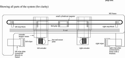

I previously posted an idea I had for a dual extruder modification that would solve the dripping problem by parking the inactive hot-end on a plate. The idea I had, for a rocker mount for the dual extruder, I couldn't get to work in practice because the rocker mount needs to be extremely stable and so would have to be machined out of metal. Also, either the mount plate would need to be redesigned, or else the rocker hinge causes the whole extruder mount to be pushed up vertically, reducing the vertical overhead to the frame to just about nothing.
So I have thought up a new idea on how to redesign the dual extruder to give it the ability to park the unused hot-end. This idea gets rid of the single dual extruder mount and replaces it by two independent single extruder mounts. The drawback of this method (there's always a drawback) is that the method to switch between extruders becomes complicated and takes longer. However, the current method requires retracting filament in one extruder a long way and extruding forward in the other, and that takes some time as well. Here, the time is taken up by motion on the X axis, which is relatively fast.
The idea is that the extruders don't need to be directly bolted to the X axis belt, but instead would be allowed to disconnect from it and reconnect. It's necessary to make sure that the extruders reconnect in exactly the same spot on the belt, because any slop in that measurement is an inaccuracy in the X axis position between layers. So the method involves keeping the existing belt clamp mostly the same, but not bolted to the extruder mount. Instead, it connects to the extruder mount by magnets, strong enough to keep the extruder firmly and precisely connected to the belt clamp during printing, but weak enough for the X-axis stepper motor to overcome the magnetic force and pull the belt clamp off (probably this can be done with some kind of mechanical latching system, but I'm trying to avoid having additional moving parts). Instead of one dual extruder mount, there are two independent single extruders, but only one belt clamp. Each extruder has a "parked" position on the left or right side of the bed plate, and when parked, the nozzle sits on a plate that keeps it from dripping. The nozzle wipes off on a wiper as it comes off of the plate.
![dual_v8_0.jpg (40.34 KiB) Viewed 20897 times dual_v8_0.jpg](./download/file.php?id=2653&t=1&sid=6d589fe17348f0f8e21d3d31e4e23574)
- Showing all parts of the system

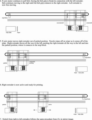

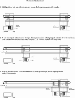

The following two pictures show how the switching between tools works. It is a 2-step process where the active extruder has to move over to the side of the parked extruder, the belt clamp switches between the extruders, then the new active extruder has to push the inactive extruder all the way to the other side to its parking spot before it can start printing. Although that's a lengthy tool-change protocol, I can't think of anything simpler that won't either have serious problems keeping everything in alignment, or require a large amount of additional hardware.
![dual_v8_1.jpg (102.24 KiB) Viewed 20897 times dual_v8_1.jpg](./download/file.php?id=2654&t=1&sid=6d589fe17348f0f8e21d3d31e4e23574)
- Switching between tools part 1
![dual_v8_2.jpg (110.95 KiB) Viewed 20897 times dual_v8_2.jpg](./download/file.php?id=2655&t=1&sid=6d589fe17348f0f8e21d3d31e4e23574)
- Switching between tools part 2
To build this, one would need two single-v4 mount plates and an extra rail carriage. There would be additional need to duplicate the extruder and bed fans for each side, and it would need redesign of various brackets, fan ducts, etc. However, there would be no need for additional machined hardware (apart from the mount plates and rail carriage, which are parts that are available). It can be prototyped pretty easily.
Anybody who wants to poke holes in my idea, feel free.

Jules wrote:So far beyond my capacity to comment on, it's not even funny
Well, the basic idea is supposed to be simple. I know I'm pretty bad at explaining things in layman terms, I think a result of having to write too many journal submissions where I had to compress a year's worth of graduate research into two pages including citations.
But the basic idea here is that instead of one gigantic dual extruder assembly, you have two separate single-extruder assemblies. Both of them slide along the X rail, but neither one is connected directly to the piece that grabs the belt like they usually are. Instead, the piece that grabs the belt is held tight to the belt, but can magnetically connect itself to either extruder (but not both at the same time).
Each extruder "parks" on its own side: The left extruder parks on the left, and the right extruder parks on the right. So if you want to print with only one extruder, you can keep the other one parked and out of the way instead of dragging it all over your print (less mass on the X axis, too). And for dual extrusion, the extruder that isn't printing is both out of the way where it doesn't drip all over the print, and it also has its nozzle physically blocked off by a metal plate, which prevents it from oozing in the first place.
