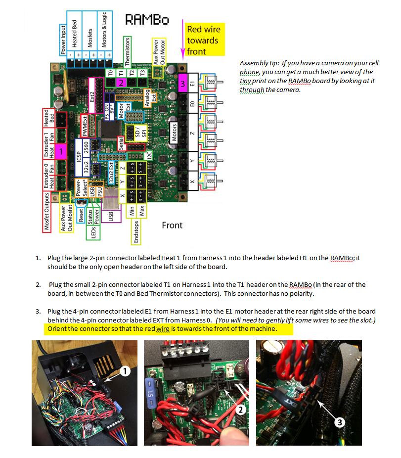

I suspect that you had the outdated assembly instructions based on when you received your printer with the upgrade.....you need to send me a private message with your email address so I can send you a copy. It's similar to the one you used, but there are differences in it that are very important.
I think one of the issues you are seeing is from turning the E1 connector backwards in the Rambo. The red wire on that connector needs to face towards the front of the M2.
From the description in the installation instructions....it's number 3. on the page.
Send me a PM with your email, I can't attach the instructions to a PM.

Thanks for this - I just checked and the red wire does face the front of the machine.
