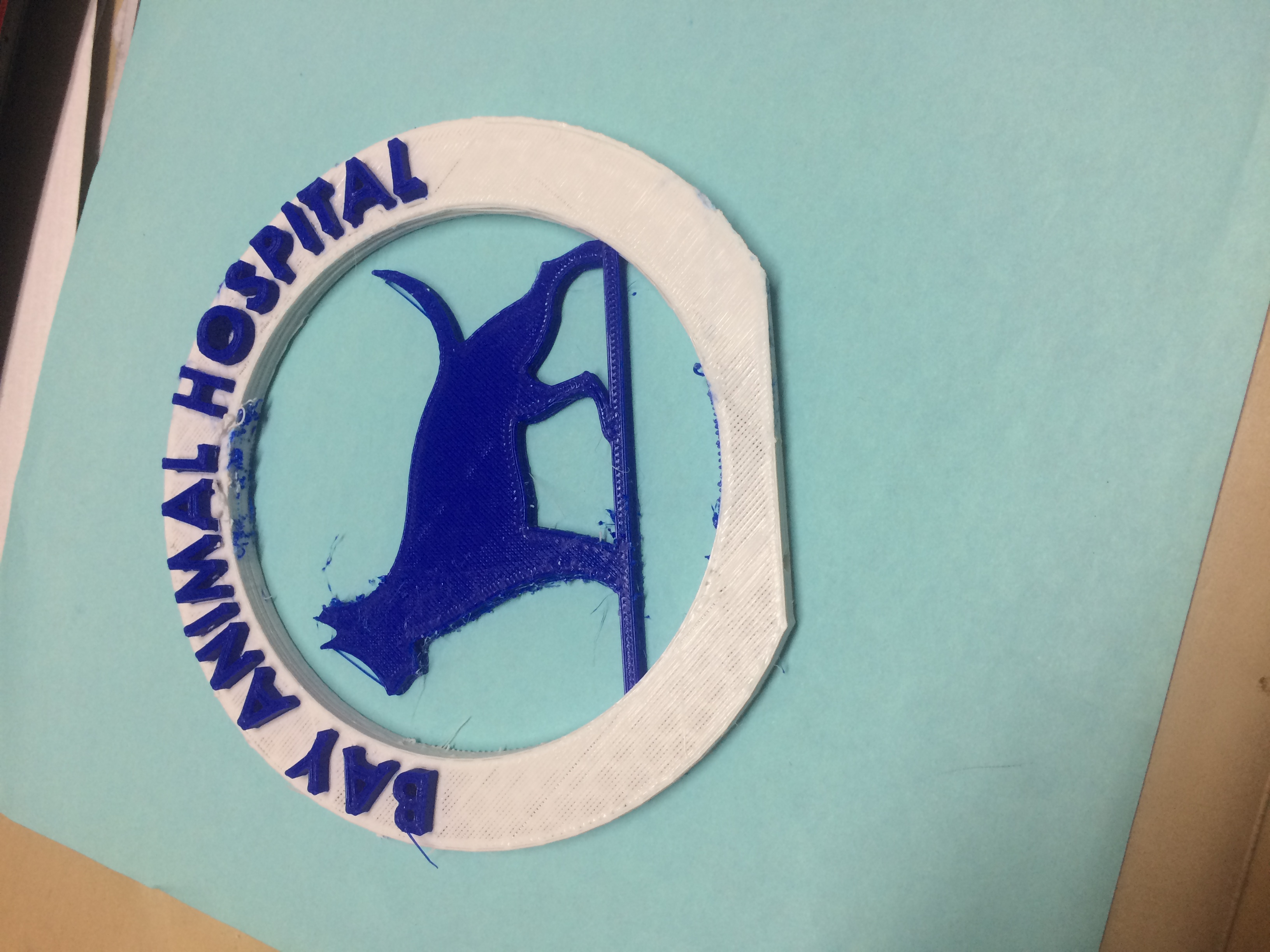

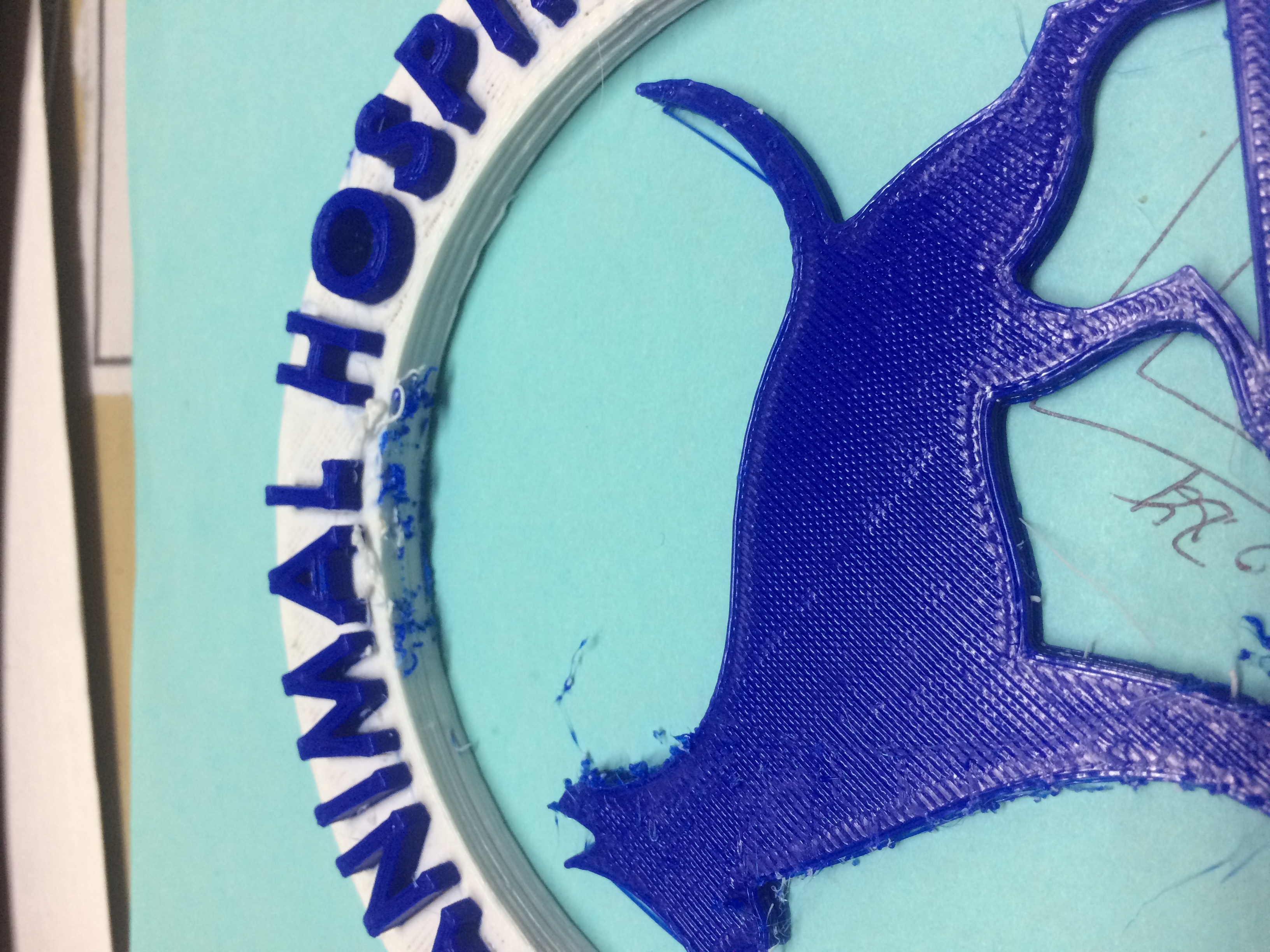

Hello Everyone. I recently purchased the dual extruder upgrade, I installed it with no issues, I leveled it following jules guide for same material extruding, but once I started printing I've run into an issue. In the images I have attached it seems that internally there are bits of material stuck, even with ooze shield being used. Does anyone have a leveling tool that I could buy? or anything that would be useful to level my heads? I would appreciate any help from the community, I really love this 3D printer and I understand that dual extruding has a steep learning curve but any help would be great.

Unfortunately, you're always going to have trouble with tiny dripped bits on that particular shape, because it has such a large open area in the center where the shields at the outside aren't going to help you.
One thing that might help, is to increase the cooling by as much as you possibly can. That means buying a small desk fan and pointing it at the nozzle that is farthest away from the bed fan. You might try increasing the retraction a bit, and lowering the printing temp.
You can try speeding it up too (particularly if you are using one of the slowed down profiles that I posted) ....I would speed that up for that kind of print. Take it up to 100%. Less time for drips to form and fall off on the print.
As a last resort....You can make the colors less contrasting to help, white and dark blue are always going to show every little drip starkly.

Jules, I'm sorry it wasn't drip. The nozzle barely scratched the surface of the blue print. I can see I wasn't very clear, is there any way I can level it correctly and not run into any issues. I didn't have drip from the PLA. I will be changing my nozzles to stainless steel so I would like to get the leveling right this time.

It's not really a drip that's a problem with that....it's ooze. The inactive nozzle is always oozing while the other one is working, and you've got a large open surface area there, giving it more time to ooze, and the tip of the inactive nozzle is brushing against the interior ledge in a couple of places.
Here's an idea....put in a sacrificial wall. Mimic the inside edge where it is brushing, only about a half mm closer to the dog shape. Atttach it to the actual wall with tabs in a couple of places, then just cut it off when you are done. With luck, the wipe will happen on the inside wall, and spare your print.
