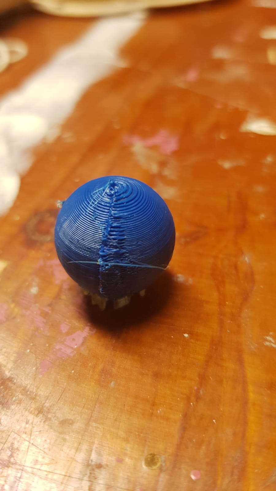

HI all,
I just have a new hot end installed, and im trying to calibrate it but im having some difficulties.
As you can see the place the nozzle starts leaves a very nasty line, anyone an idea on how to minimize this?

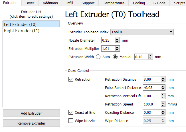

These are my settings:
Thanks in advance

I actually did a lot with the single wall square and some with the extrusion squares. but my question is more basic.
I dont know which parameters to change here, whatever I change there seems to be no significant change.

Post by Mazhdulin » Mon Feb 10, 2020 12:06 am
I have seen the guide but none of the issues listed is comparable. I want to make the start stop position blob smaller.
