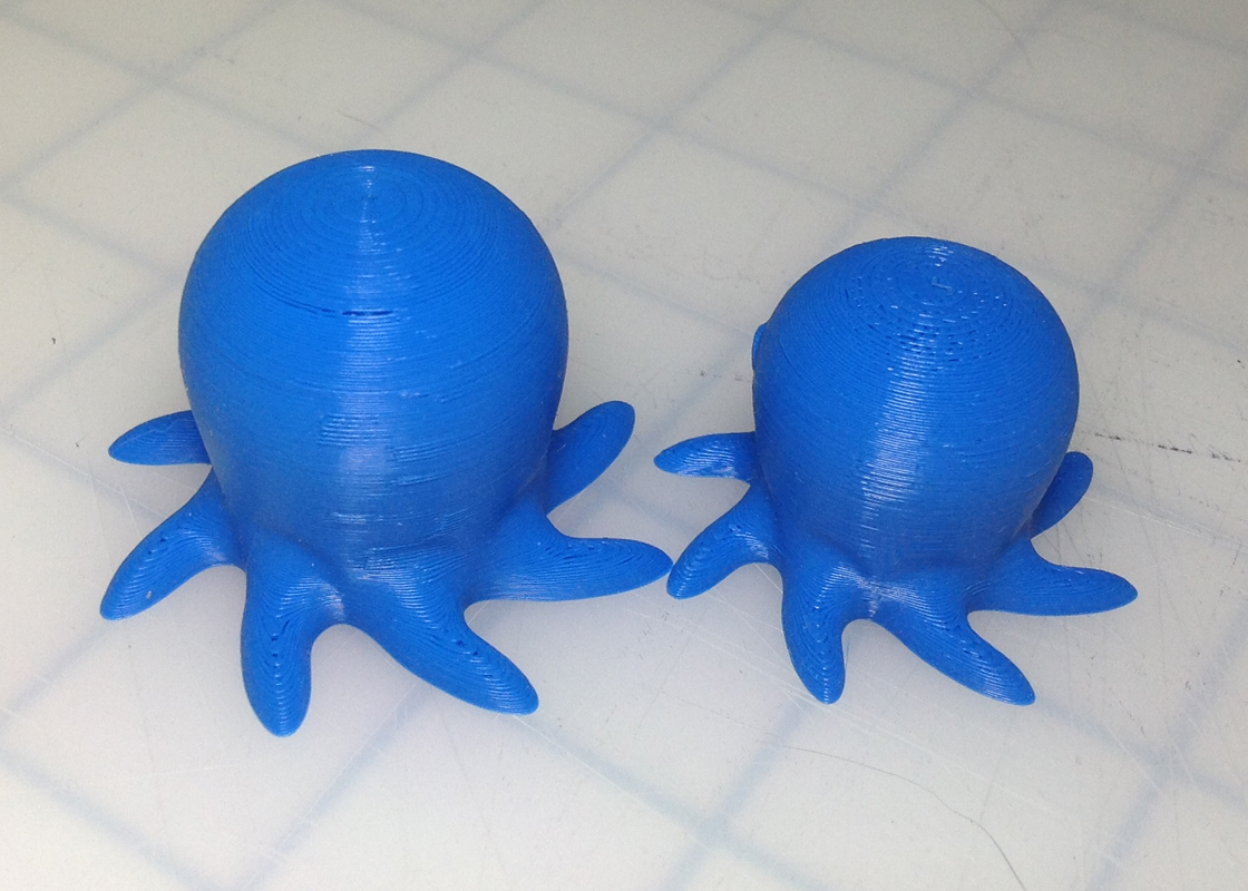

The M2 filament is fine, i've printed rolls of the stuff with no blobs. You've got a setting off somewhere.
I ran prints of the little octopus on both version 2.2 and 3.0. They both turned out fine with no major globs, although the version 3.0 did show a slight tendency to create little ridges at the start....from doing that back-up thing. It's not really noticeable though, so i think it can be discounted as a factor.
Larger v3 on left, smaller v2.2 on right. Both have really good quality for drafts.
If you are up for one more test - i thought of something that happened with me when printing PETG. If the nozzle is just a hair too close to the bed for the first layer, the tip can drag through previous layers and collect a little blob that gets deposited later on the print.
Reload the settings I gave you, change the infill back to 15% (you don't need to spend forever on a test), and in the G-Code section, add a value of +0.05 into the Z-Offset slot.
Give 'er one more shot - this might fix it.

Yep, still have the blobs with the Hatchbox filament but the overall print quality is slightly better.
I'll give it a shot, thanks Jules. My prints octopus really isn't that far off from yours at this point. I am printing them at 40% scale (so its a 7 minute print), this makes my imperfections appear bigger.
