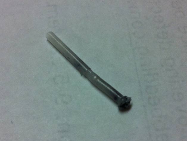

Pic of the plug that came out - that tube is hollow, and it's the residue left on the walls of the barrel after you retract. (Caught most of the crap that was left on the walls, too.) The crimped spot is where i caught it with the tweezer nose pliers and pulled it out of the nozzle.
Eeeew! All that carbonized crud on the tip!
