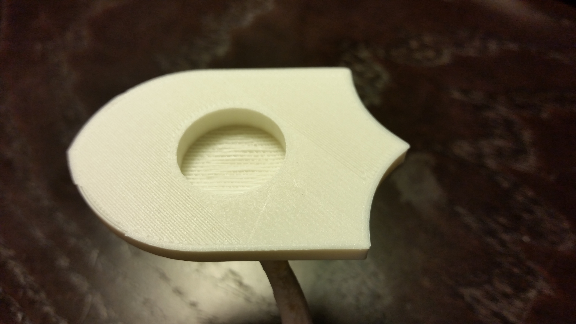

Got the Buildtak on the glass and I did a test print. Test print being yet another tiny set of antlers the girlfriend wanted printed.
the bottom layer adhered perfectly to the material at room temperature. There's a section at the lower right of the picture below where the bed was still too close to the nozzle. i ticked it down one notch but that seemed just past where it should be, though it still adhered just fine. i had adjusted the bed height a bit after i put the Buildtak on but obviously it wasn't quite right. there's also a bit chipped off one edge where i pried it off the bed. i wasn't being careful at all, and the outer walls of the first layer were super thin anyway due to the incorrect bed height.
so far it works as advertised with PLA. the real test will be many prints over the same area to see how the adhesion holds up. also, once my all-metal hot-end mount arrives i'll get the e3d installed and test ABS on the material as well.
