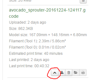

Post by Hugs » Mon Dec 26, 2016 7:41 pm
3dPrintingMD wrote:where it does have memory of the last time you printed the object and how long it took.
Click the little arrow to expand the details. You will see that info:
