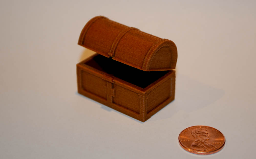

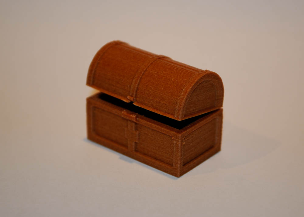

I had a sample of Zen Toolwork's Dark Wood Filament I received with there flexible stuff I ordered so I gave it a shot. What better to try than a treasure chest.
This first picture is how it came off the printer. I printed this with a .35 nozzle running the stock med. setting in S3D. (it prints between 190-230) I only had a small sample so this is all I printed but I didn't encounter any problems.

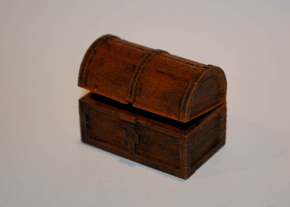

(Penny for scale) I heard these wood filaments could take stain so I decided to try it will a gel stain I just used on another project. It kind of got a little darker I guess but to be honest the stain was lighter than the filament I was staining.
For shits and giggles I also tried dry brushing on some black stain with a q-tip just to see if I could get a grainy look like wood. I probably should have used a brush but its not to bad all thing considered.
I'm not sure what you would do with this kind of filament it kind of seems like brown PLA to me but its cool to have some options I guess.
