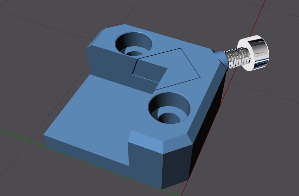

i just finished modeling this and havent printed it or tried it yet. i will post up the model if you want to give it a shot to see how it does. i know you were asking about the bed clips. this should hold the bed glass in place so there is no movement and not stick up past the glass. just give me some feedback on tolerances etc. its set up for an m3 screw. hole will need to be tapped or the screw just threaded into the hole.

jimc, did you intend to post an STL or other file for the bed clip? I'd also like to try it.

haha yeah here ya go. i have a version of this thing on my m2 but it was quick and just uses the screw. it works really well. its not meant to be a clamp or put pressure on the glass, just take out any play so there is no movement. forgot to mention these are modeled in inches. s3d should scale it automatically.

Looks nice! I am about halfway through the fan mount. Will have to print those brackets tomorrow. Is PLA okay to to print those in or should I use ABS since they will be touching the HBP?

Thanks again for the help! Can't wait to try out those bed corners!
Re: I have officially joined the community!
Post by jimc » Thu Dec 18, 2014 2:46 am
i would most certainly do them in abs
