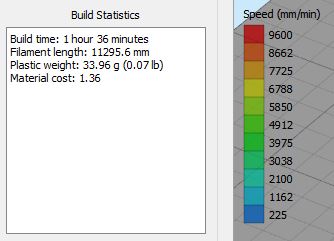

Post by Slipshine » Mon May 16, 2016 3:49 am
in simplify 3d after you select prepare to print in the top left corner it will tell you the length and weight of the plastic required.
When you get a new roll weigh it . Example 1150 grams
since there is 1000 grams of filament on a new roll you can figure the spindle weighs 150g.
If you prepare a print and it says it needs 200g of filament all you have to do is weigh the roll and subtract the 150g that is the weight if the spindle to see how much is left on the roll..
Example: the roll now only weighs 600g
you subtract 150g for the spindle and leaves you with 450g of filament left on the roll.

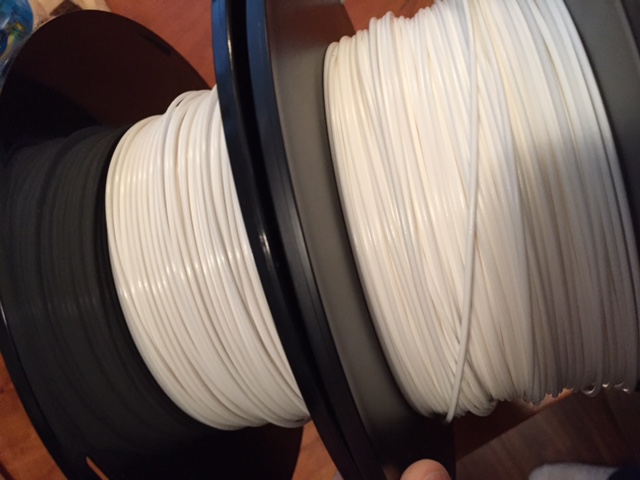

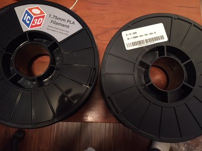

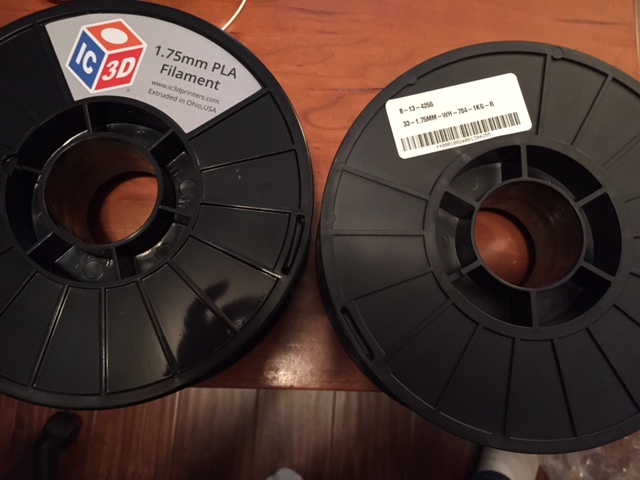

Post by scampa123 » Mon May 16, 2016 4:04 pm
Thanks Slipshine!
Here are two spools I'm currently using...You'll notice they are both white PLA...I started a separate spool because I was worried I'd run out of filament on a long print...but now I run the risk of having allot of partially used spools...
Slipshine wrote:Scampa123 - If you post a pic of the roll I might be able to get you close on the weight of the spindle.
I might have a similar.
Filaments
Spools

Post by Matt_Sharkey » Mon May 16, 2016 5:37 pm
The roll on the left has more than you think...

Post by Slipshine » Tue May 17, 2016 2:32 am
It closely resembles a Makerbot roll of abs I have.
I would put it at 330 grams
