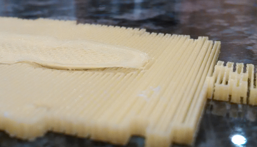

Goofing around some more today I'm trying to print a boat shape. There is very little of it touching the bed, it's almost entire up on support. After just a few mm I'm noticing that the boat shape is pulling up higher than the level of the support around it, so I stopped the print. There seems to be no issue with bed adhesion, it was all stuck down fine. I'm using Simplify3D for slicing and printing the model in PLA.
2014-04-20 19.57.52.jpg (183.93 KiB) Viewed 19595 times
Any clues how to address this?
