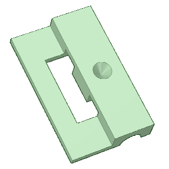

I'm going try to have a friend of mine with a milling machine make something like this. The filament channel is split by bridges in an attempt to keep the heat contained to the center portion. The handle bit is for pliers. There would be two of them. The cone on the back is intended for introducing a soldering iron or a hot printer nozzle. Maybe some alignment pins. Possibly move the bridges to the mating face to try to keep them away from the heat cone. Not sure what is possible machining-wise or material-strength-wise.
Anybody have any objections why this wouldn't work?

First reaction- I think if the filament melts in the center section then it will likely melt into the gaps between the channels as well. I would keep the bottom part one continuous channel and split the top part into three sections- left, center and right, with just a hairsbreadth separating them.
The center takes the heat and the left and right hold the filament in place. Also, make the left and right channels longer, both to better secure the filament and also to have a wider margin of error for how much away from center the filament melts. It may take some practice but I think you'll learn by experience how long to apply the heat to make sure it doesn't melt outside the channel.
And if you want to be fancy, curve the model so that it better matches the natural curve of the filament. I just started modeling my own version of it that way for printing and casting in plaster. I think yours has a better chance of success, but it will be fun to try them both.

I think I had a drawing error, the center portion should be 5mm long. I think the channel is drawn with a 1.75mm radius, not diameter, so the melting part is longer than it appears in proportion.

I only had time to make the bottom portion of the mold this evening. One suggestion based on this: make the channel a fraction larger than 1.75mm, say 1.77 or 1.78. The filament just barely fits at 1.75. I don't see any reason to be that tight.

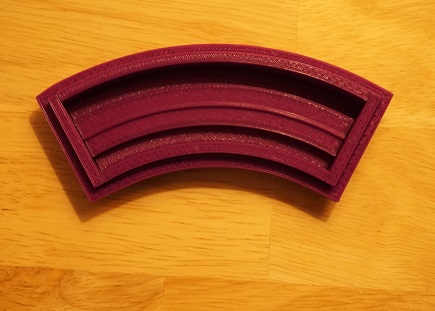

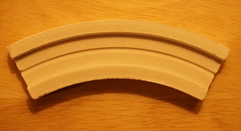

Here's the PLA mold and the plaster cast from it:
Re: Creating 3D QR codes
Alas, the heated plaster is capable of melting the PLA, but heating plaster causes it to degrade in just such a way that the melted PLA bonds to a fine layer of plaster dust, which stays with the PLA when it's removed. Not something I want to run through my hot end.

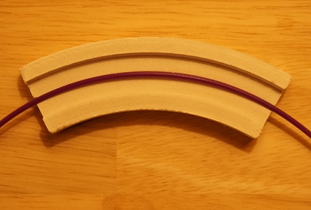

In terms of casting objects with geometry on all sides, yes you can do it. Here's something I cast just to test that very process: The underside of the model is the same as the top side, so they both have that inset in them. It's a question of the mold fitting together so the last piece can go in without needing more plaster after it. Or else you model it with two extra tubes sticking out- one to pour into and one to allow air to escape. If you get into doing something like this we can compare notes. It's a lot of fun, especially if you like geometry visualization problems.

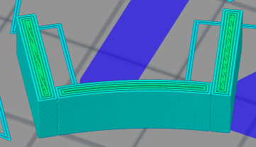

Toby, looks like there might be an issue with TobyCad that's causing some strangeness to occur with the retaining walls. Are you sure they're fully joined up? They get sliced like this, which is not ideal:
