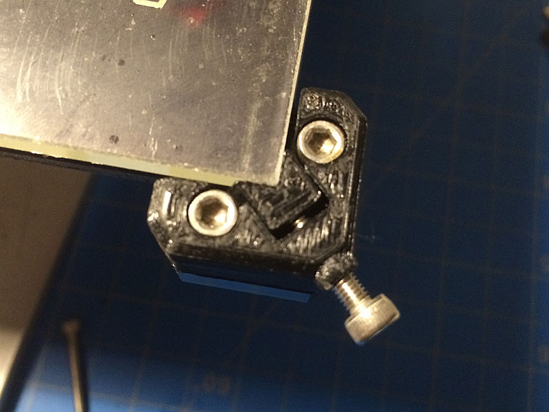

I printed one of the corners. Things are just a little tight so im going to make some mods and repost it.

Post by jimc » Sat Dec 20, 2014 4:36 am
sorry for the delay on this. i had present wrapping duty last night :cry: so i got all the tolerances right on this. i printed this in black petg and everything fits perfectly. just a hair lower than then glass surface so you can adjust these to your glass so that all play is removed so no clips should be needed. i certainly havent done any long term testing but they fit great and work great so far. the screw hole is setup for an m3. with the petg i have here i was able to just thread a screw right into the corner but with abs or another plastic that doesnt layer bond as well you will need to probably clean the hole with a drill bit and tapping the hole would probably help. also, you dont need the screw on all 4 corners. just the 2 front corners seems to be enough. i am going to post these on thingiverse. you guys that try them out let me know how they are working out for you.
