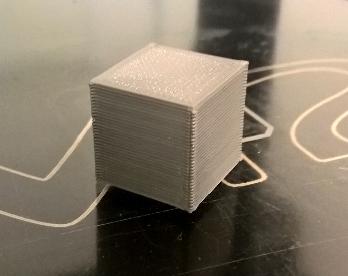

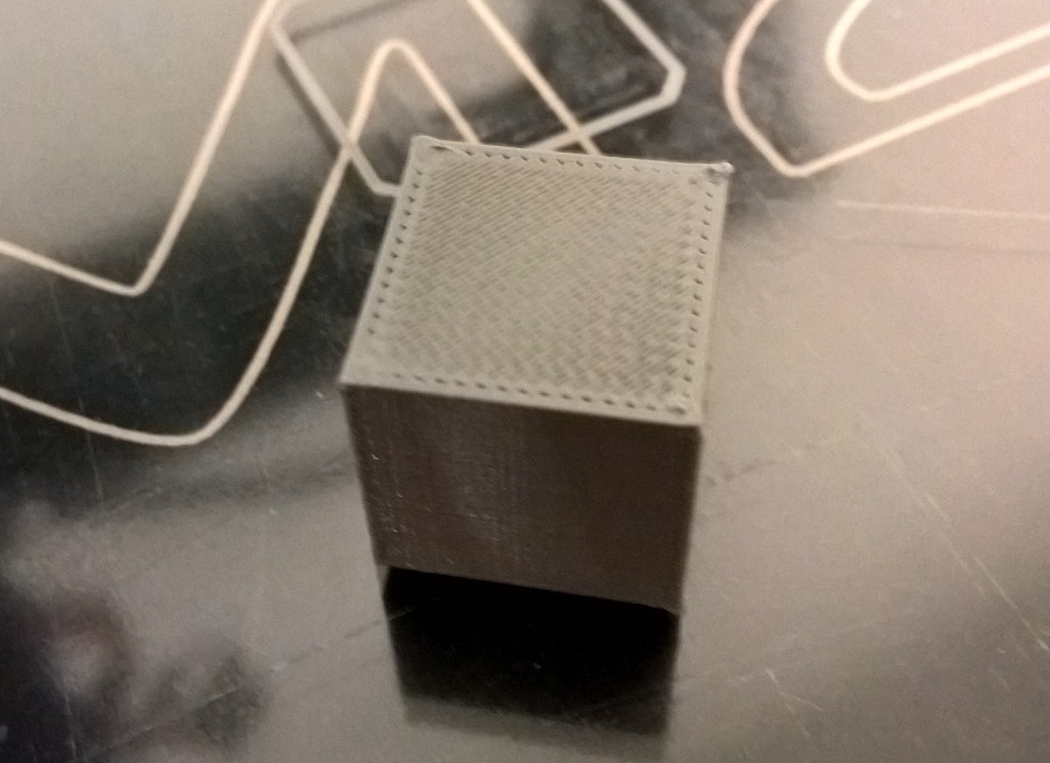

Post by desman » Fri Aug 07, 2015 1:14 am
The cube printed with the settings supplied by Makesolid.
