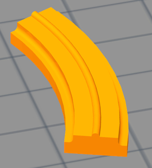

That's just laziness on my part. I didn't model it as one piece because the arced part was easier to model as a sweep and the ends as lofts. It'll print ok- not perfect I know, but it's just a tool to make something else. I've never had a problem with a part like that as long as it's tall enough that the join has plenty of opportunity to stick. It doesn't have to be super strong, and even if breaks it doesn't matter because the frame surrounds the whole thing and holds everything in place while the plaster sets. (EDIT: I was careful with the frame and modeled it as one piece.)jsc wrote:Toby, looks like there might be an issue with TobyCad that's causing some strangeness to occur with the retaining walls. Are you sure they're fully joined up? They get sliced like this, which is not ideal:
Did you print and try to cast with it yet?
