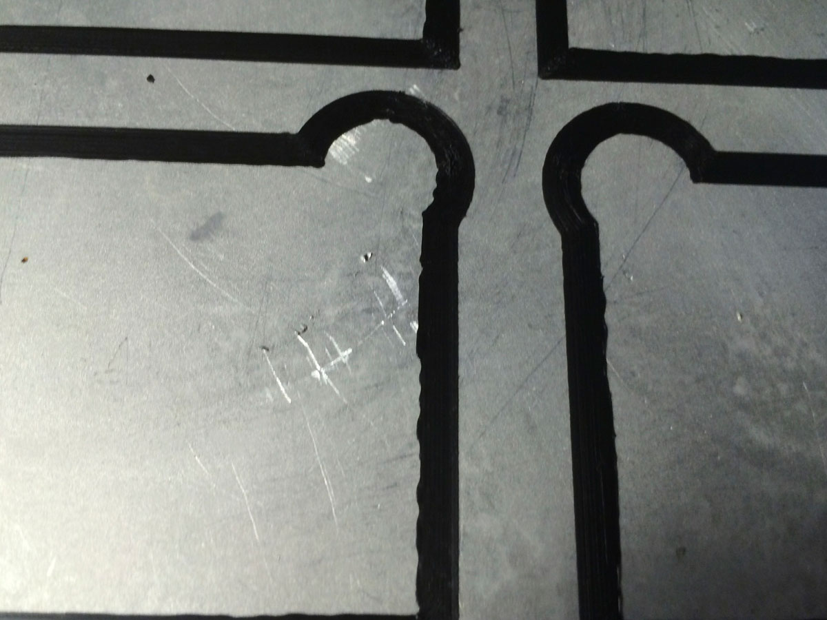

here i just started a print a min ago and it has a wide skirt so i purposely turned my z-height adjustment knob to raise the bed 1 click so you could see what happened because now i am printing too close.

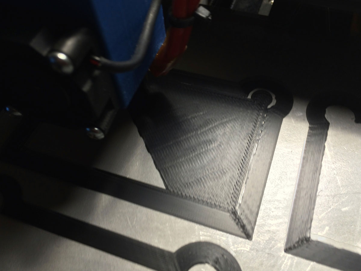

and here is another of the first layer infill. if i turn the knob and drop the bed 1 click this will print perfectly. of course you want to get your adjustment bolt set and not do it with the knob. i just did it to demonstrate.
