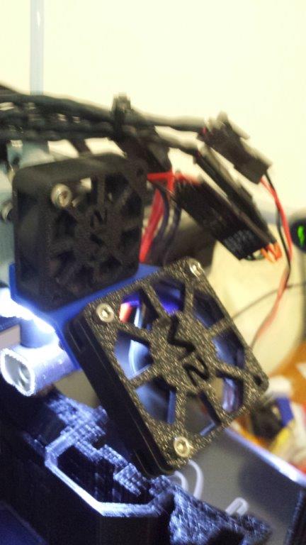

I have added Fan bracket with LED’s that Dale created. This makes the web camera look much better.
http://www.thingiverse.com/thing:348480
Now I don’t need to leave the light on in the room where the printer is.
I added the printer to my home automation I can turn on/off the printer power from our phones kindles latoptops…
I turn on the power to the printer then startup Octoprint and get everything hot before I go in the room.
The next step is to have octoprint turn off the printer power when the print is done. The G code turns off everything but the power supply but I will have it turn that off also.
I have been just copying the print files to the raspberry Pi and printing from there. I have not had one issue with this and I have printed for many hours doing this.
