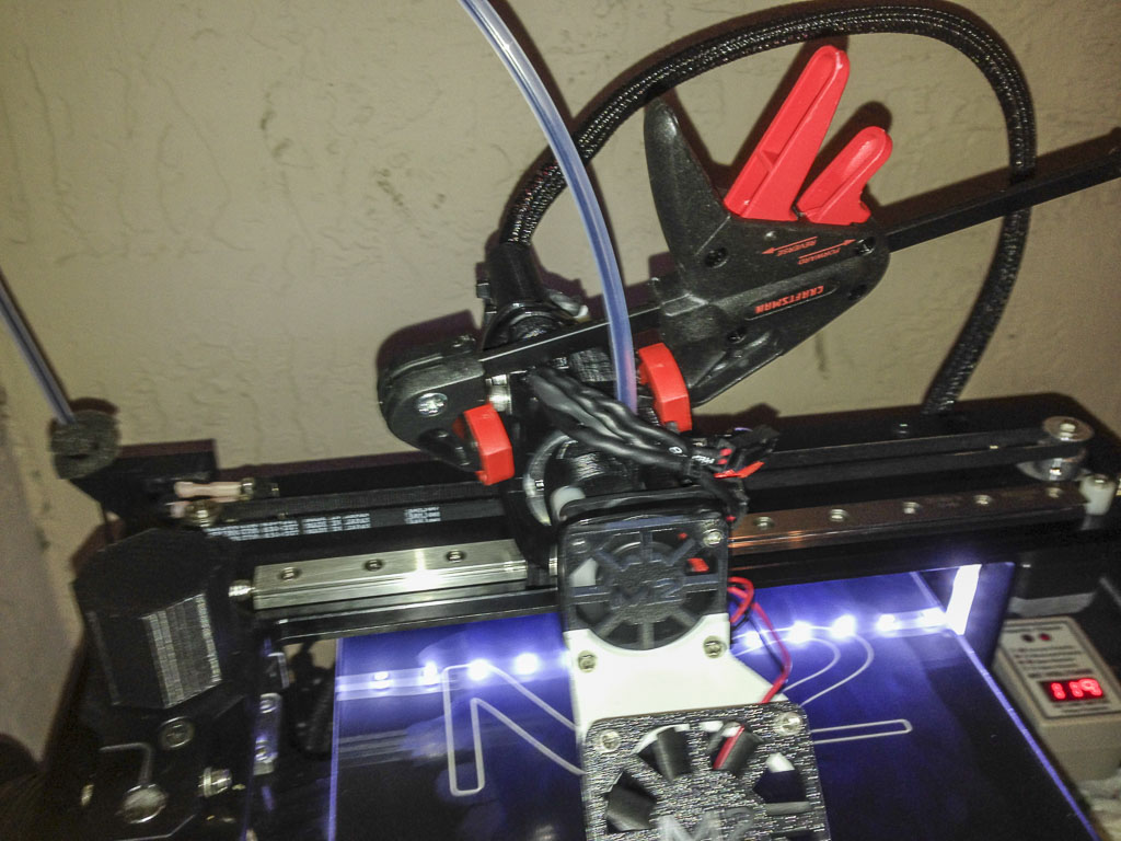

I had this happen today. Broke near the hole. Unfortunately I had not printed replacements yet since I'd heard so many horror stories about ABS I was trying to get my practice on PLA first. Didn't think it would go out so soon, about 20 hours of run time I guess it had on it.
Anyway, what to do! I removed the motor, put blue Loc-Tite around the area that the motor mount contacts. Put two super tight ty-wraps around the mount, then used a Craftsman Micro Clamp on it. The clamp is pretty light weight (all plastic except for the aluminum fingers and shaft, so it doesn't seem to be a big load to the belt motor, and gets a good grip with its rubber boots on. Its currently printing what appears to be a flawless motor mount (thanks to the rsilvers FFF file). The clamp by itself probably would have been enough, but I remembered I had purchased it after already putting on the Loc-Tite. Here's the picture with the clamp on, I'll add a picture of the finished product (if it finishes :) :
