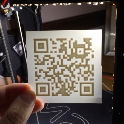

I am trying to find a way to create a .stl for a QR code I have in .png and .jpg. I have tried a few different methods including this- http://www.thingiverse.com/thing:46884 where I get an issue with the data outputs. Have any of you successfully created a 3D print of a QR code and how did you manage to do this?

Well, an absolutely accurate 2D to 3D extrusion of a QR code would not be manifold. But, if you are using Simplify3D, my first inclination would be to try to throw it at the Image to Model tool embedded in there. Maybe the image smoothing it uses would get around the manifold issue. I will check for you later.
Re: Creating 3D QR codes
Post by jsc » Mon May 05, 2014 4:33 am
Okay, so it worked. This is just a proof of concept, I made it rather oversized. I just used the Image to 3D tool built into SImplify3D.
That thingiverse file has some ideas for how to get one that doesn't require a backlight: coloring in the top layer, using different filaments, reversing it and inlaying into the valleys... once dual extrusion is here, you can just print it out in two colors.

What material did you print that on? It looks pretty good. Thanks for your help!

White ABS, but I think it hardly matters, just something that is translucent enough for the backlighting to show through.
