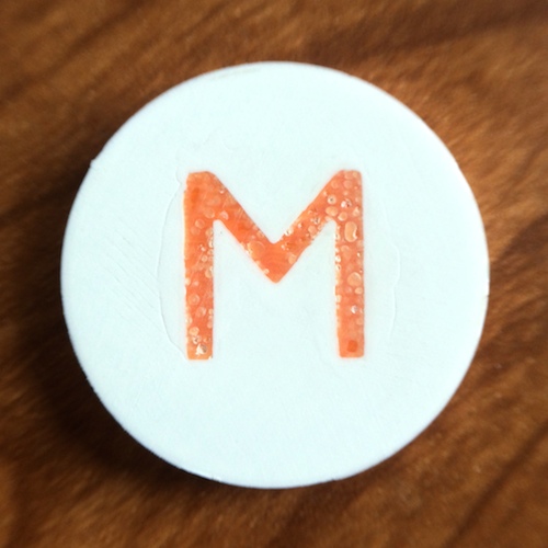

I posted this elsewhere, but now I can't find it. Anyway, this isn't suitable for more than a handful of parts, but for a few one-offs, it could work:
PLA with ABS inlay placed as ABS soup and sanded down.

For the example shown, they sure picked a hard way to do it. No need for dual extruder or slurry inlay, just print two pieces. The trick is having the software that will do the one command that makes this a piece of cake, which is Offset Solid. There are many ways to do this same operation, but I will give you my version, since I use Rhino.
To make the example pictured, which looks like a drink coaster, here is the workflow.
Create a 100mm circle, extrude it into a 6mm cylinder.
Create a 50mm tall letter, extrude the text 3mm.
In the software, place the letter on the cylinder and use Boolean Difference to punch the letter outline from the cylinder.
Use the command Offset Solid to shrink the letter inward by .20mm. Simply scaling down the letter to fit the cutout will not work for all letters, try it and you will see why. The software features available are going to determine how you do this. You could also expand the cylinder, or explode all the surfaces, offset and trim and rejoin, or offset the letter curves instead of the solid (most software will let you do that) and then re-extrude the letter. There are many ways to skin this cat but offsetting, not scaling, is the key.
Print letter and cylinder.
Trim, inlay, and glue.
You may have to mess with the shrinking/tolerance to get a perfect fit, depending on your printer setup. Be especially careful of the flange around the letter, it may need trimming.
