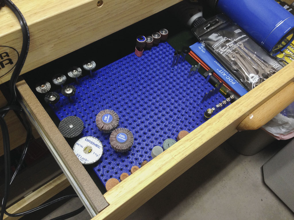

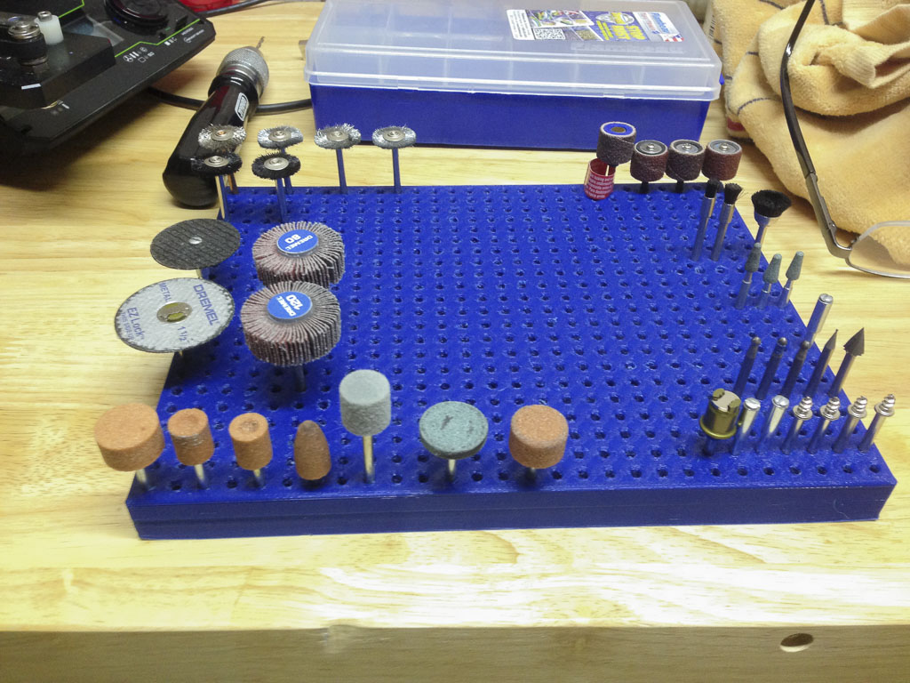

Just to finalize the thread I did finish the project, and as luck would have it I mentioned previously that up to now I had guessed hole diameters properly on previous projects. As it turned out I was off on, of all projects this one with over 600 holes! So my Dremel drill press got a workout expanding all these holes. By the way, Dremel totally sucks on drilling PLA. Totally bogs down. I have the battery powered Dremel and the top of the line AC model - terrible torque for drilling, seizes up completely. Ended up doing most of them with my hand driver visible in one of the pictures.
But all's well that ends well...
